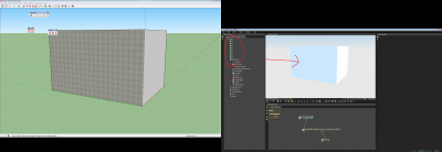

Create material..."FasadeA" in SU and this happen???
New material "FasadeA" are created outside Octane Sandbox but still links to "[Chris_Skin]"???
NB: And same time materials in ocs proxies vanishes....

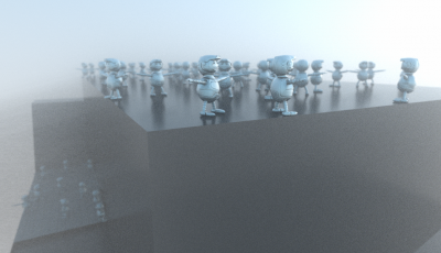

Now fog works....finally!
Win7 Sp2____2xGTX1060 [email protected]____Su17.2.2555 and Su18.0.16975____SketchUp Plugin 4.00.0.17____4.00.RC7 Standalone

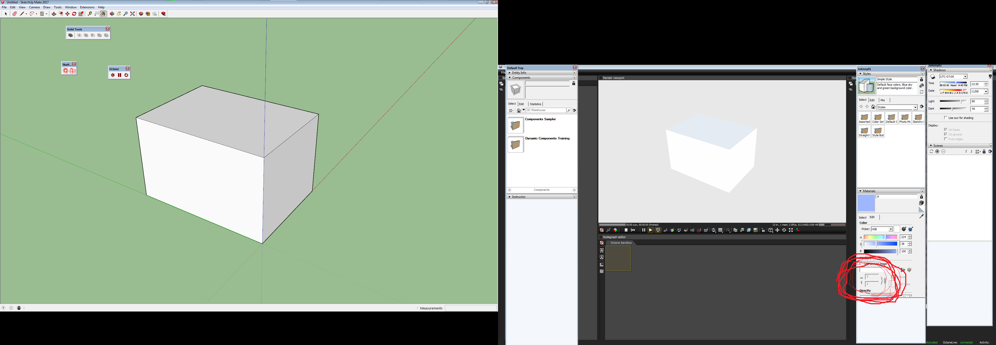

UV bug
Every texture (UV transform) are scaled with a foot value in cm??? (I´m working in m). In SU it display foot, but when i click it change to m.
Trying to scale the texture in SU and the material get several spontaneous clones and vanishes. See picture. Very strange???
Edit: Actualy it´s inches> 1000mm in SU/25,4= Displayed value in Octane
