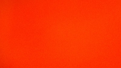

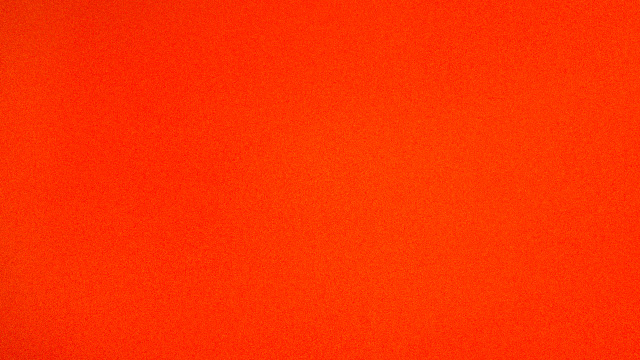

Seems like network rendering has broken in this version.
It renders fine if I don't enable network rendering. But as soon I enabled it, I get red blocks in the images. In small resolutions it's the entire image that renders red.

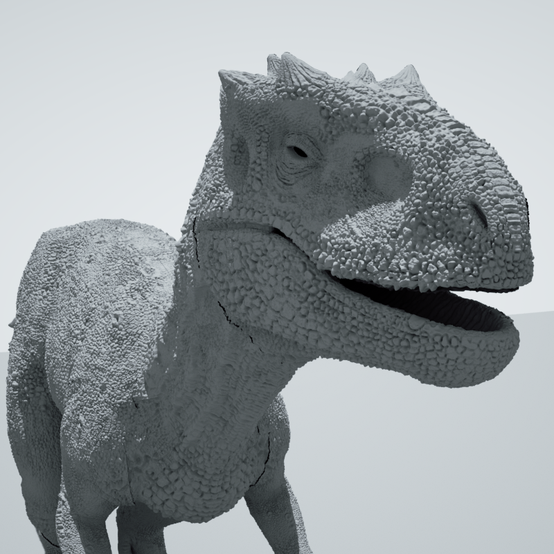

Just to let you know: Roeland found and fixed the normal issue: Btw, I noticed that you subdivide the geometry with a sub-division level of 3. I think that's not necessary. The render above uses no subdivision surfaces at all.Jolbertoquini wrote:hum... same here really hard to get details on displacement, I need add bump to get right. but stills the gaps.
I attach renders and scenes... Please anything wrong I tested on Redshift, Iray, Arnold same setup all good out of the box.
this is a free scene from Truong CG Artist.
Cheers
JO
The normal fix will be in the next test build which we hope to get out tomorrow.
PS: I think there is also a possibility to close the gaps at the UV seams, but the solution I have in mind would basically create a "straight wall" where now are gaps, i.e. it would still be desirable to have a continuous displacement map.
Thanks a lot for the report. We could reproduce and fix the issue and hope to get a build with the fix out tomorrow.Zay wrote:Seems like network rendering has broken in this version.

abstrax wrote:Just to let you know: Roeland found and fixed the normal issue: Btw, I noticed that you subdivide the geometry with a sub-division level of 3. I think that's not necessary. The render above uses no subdivision surfaces at all.Jolbertoquini wrote:hum... same here really hard to get details on displacement, I need add bump to get right. but stills the gaps.
Cheers
JO
Hi Abstract,
Nice thank you for the work on this, yes I had subdive to have more details or trying to see if was need, thanks to let us know not really need, would be great at some point when the normal issues and the gaps are fix to send this scene with your settings would be a help....for the texture I was checking because I moved the displacement with the bump texture and then I had this issues on the level I will try again. I'm really excited to see the fixes
Cheers,
JO
