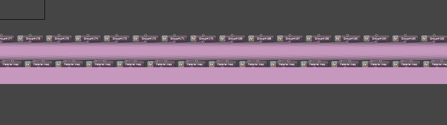

all these nodes are completely useless, i can't navigate in this..
am i doing something wrong here? i just wanteded to copy a camera (for safty reasons, as i can't lock it), then i selected "show in graph editor" and......
jorgensen
jorgensen

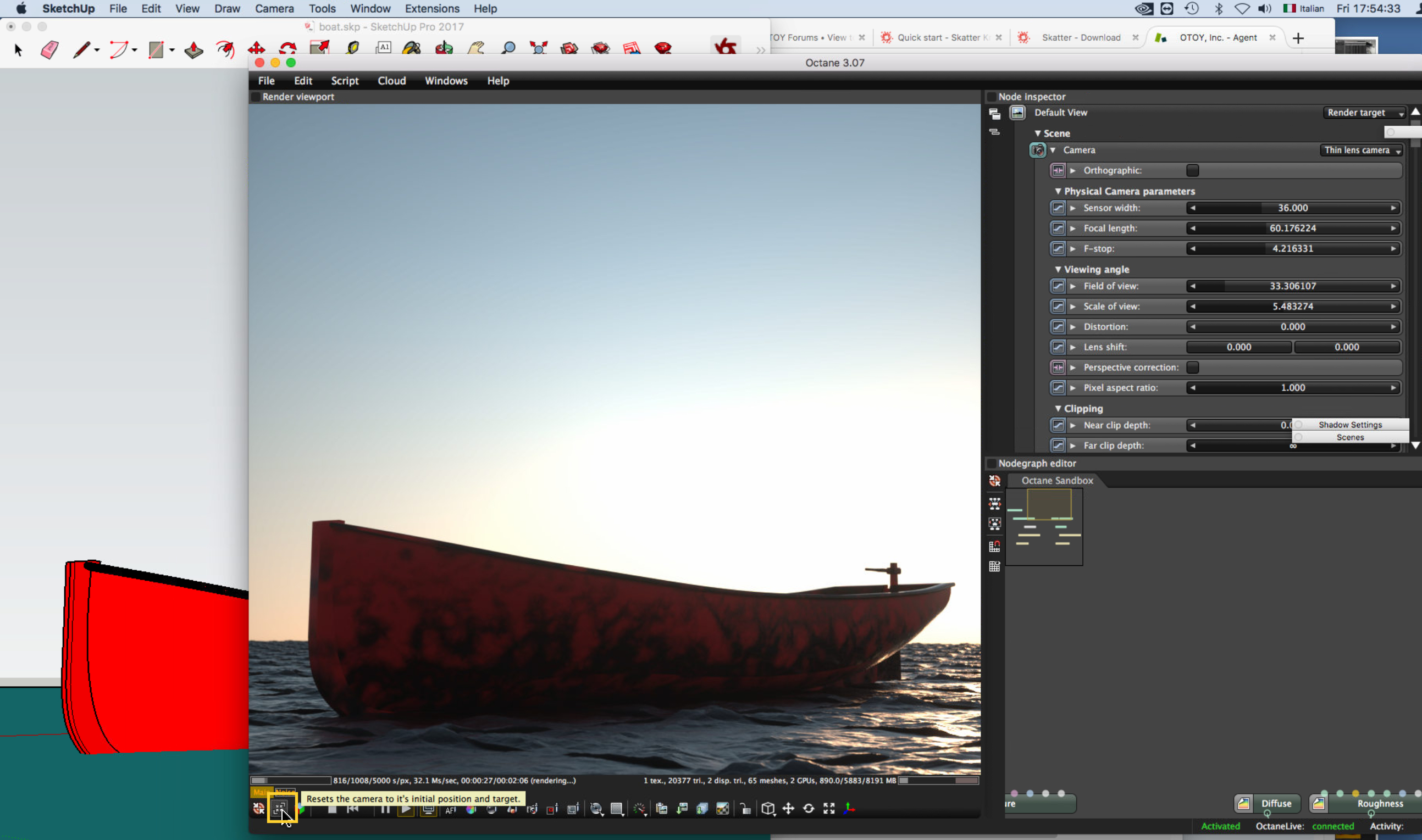

Hi Jorgensen,
you need to select the Default View Render Target, then choose "Show in Graph Editor", and expose the Camera node.
Note that you can navigate in Viewport, and press the icon in screenshot, to go back to the first camera position exported: ciao beppe

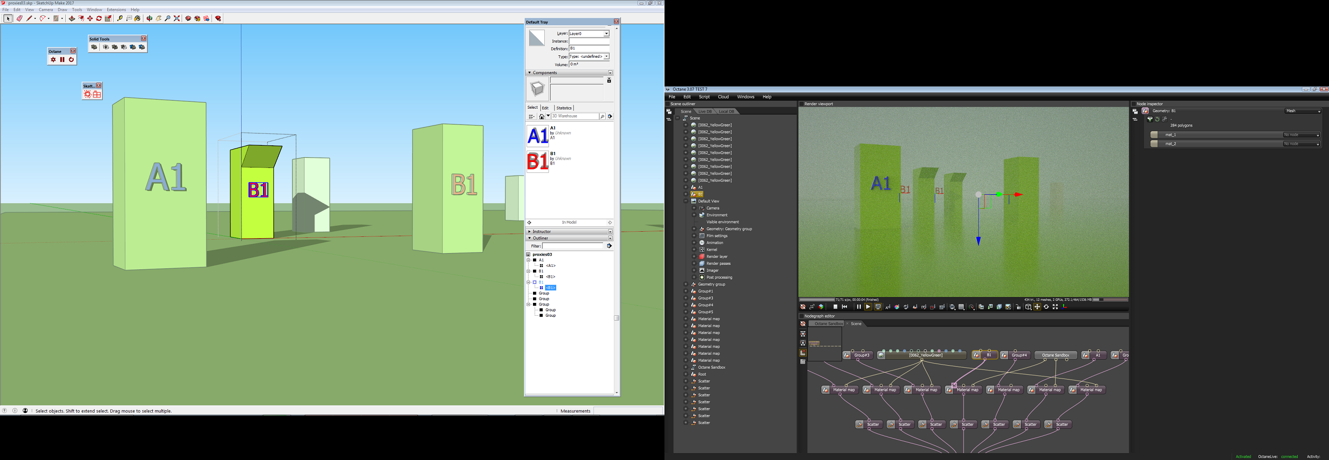

At least this was what happened to me. I closed and reopened and proxie OK. But got a LOT of extra nodes (see image "ocs_groups2.png" in next post).
Win7 Sp2____2xGTX1060 [email protected]____Su17.2.2555 and Su18.0.16975____SketchUp Plugin 4.00.0.17____4.00.RC7 Standalone
When using groups things get complex weary fast, and the consistency of how groups works inside SU and octane are not god. A strategy on this are important.
Should we only use components?
Maybe the developers of Scatter for SU has some input?
When exporting to Standalone and reopen, a file consisting only of 4-5 cubes, it gets insanely complex (see "ocs_groups2.png"). Azen, haze, beppe, CaptainCrowbar.....anybody?
