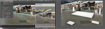

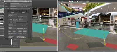

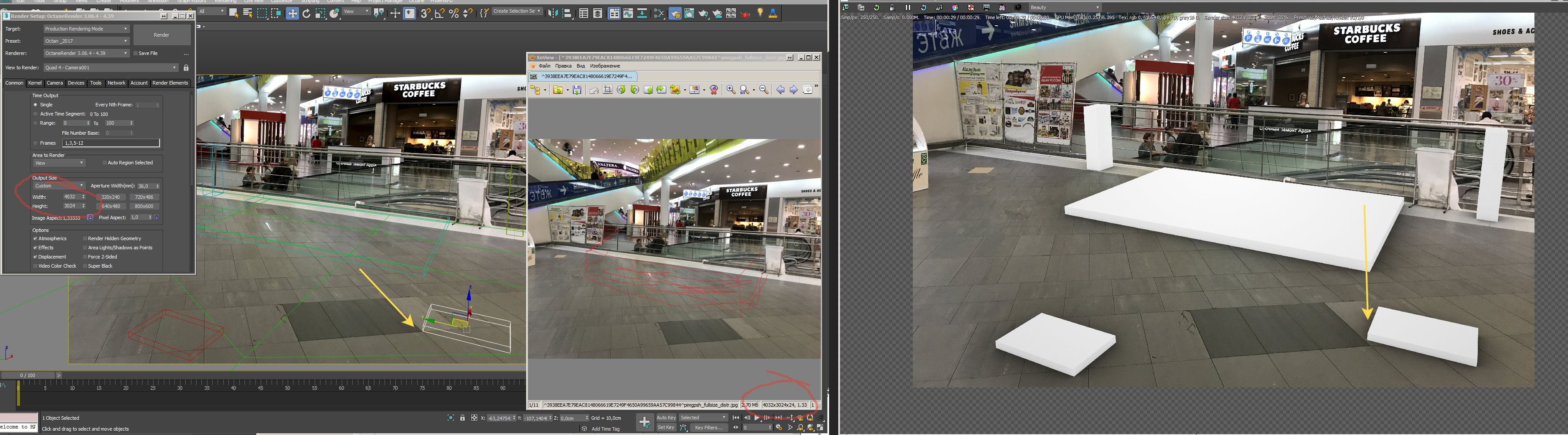

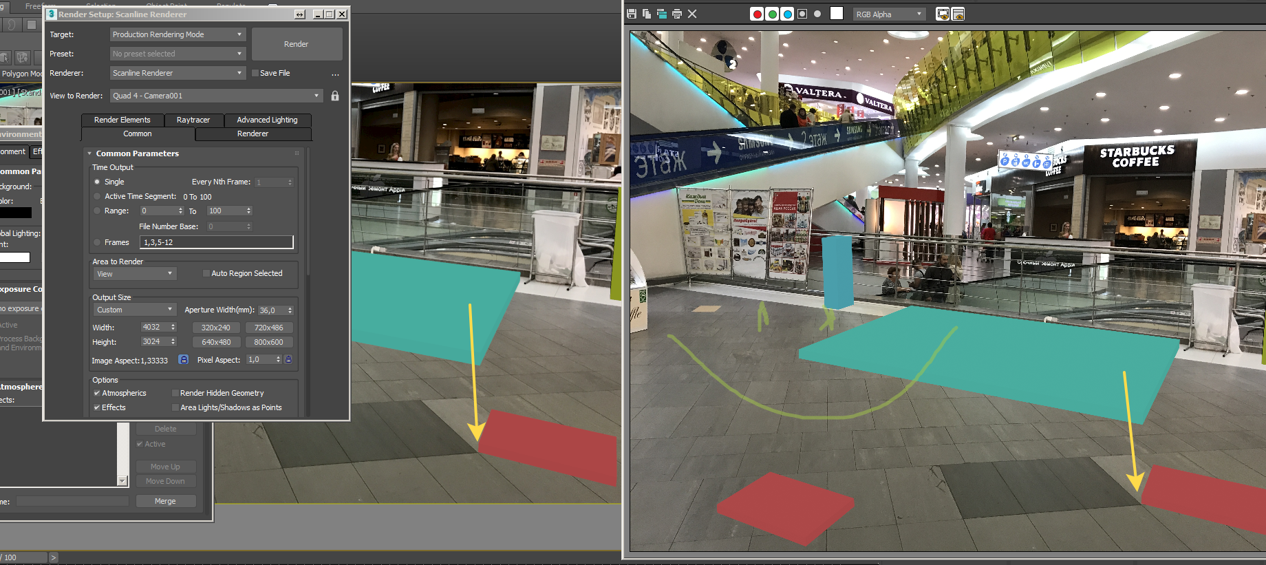

does not work correctly in free camera
you say that this render is made of cinema -- why doesn't the tracking camera - if I'm wrong show me how to do tracking with octane render

obviously none of 3dmax did not tracking camera in video production .... a year ago I raised this topic - nothing has changed or, again, a mistake that was a year ago .... Don'T TELL ME to use the Octane render camera - I'm still not going and not going to use your camera

Welcome to the club Goldisart. There are some semi bad or good solutions here. I had to get over this never solved bug many times and lost time with the work required camera matching. Officially it can't be fixed as I understood.
Here is a link with further links in the thread: viewtopic.php?f=27&t=54372&hilit=camera+match
