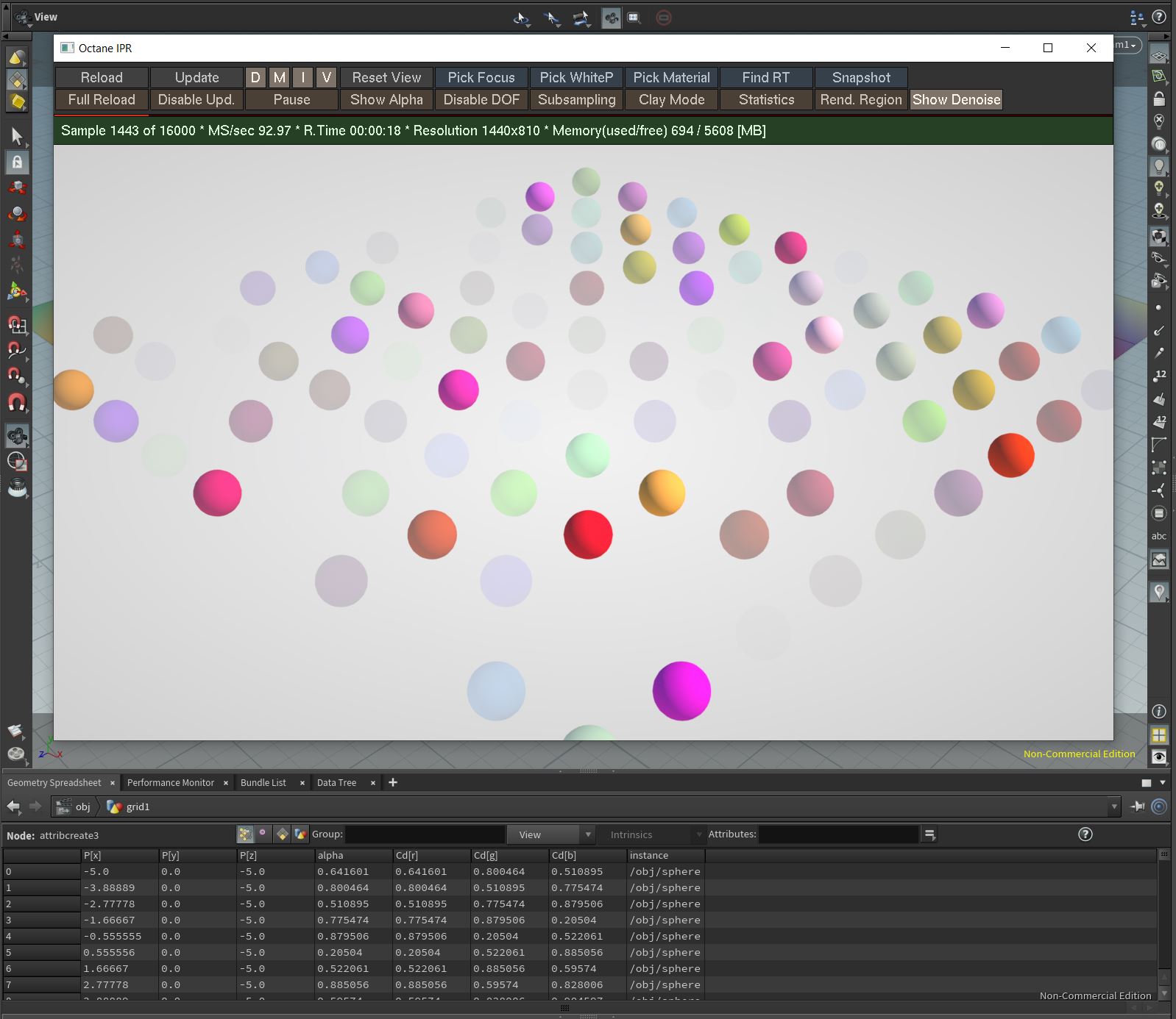

work great now on obj instance. A last thing again, can I use a 4th custom parameters through alpha data ?
I tried to add @alpha data in point with in material a NT_TEX_INSTANCE_COLOR instance with alpha4k_map.ppm file, no success, any idea to use it ?
thanks

Hmm, nope, sorry. The alpha can't be handled using this workflow. I'm not sure if this is going to be possible without the proper support for instances point attributes, but I'll check it out.

efxlab wrote:work great now on obj instance. A last thing again, can I use a 4th custom parameters through alpha data ?
thanks
The next Octane 2020.1 plugin build will support the @alpha float point attribute inside the instances packed RGBA values ;)

efxlab
Posts: 54
Joined: Thu May 31, 2018 5:23 pm
amazing Juanjo,
I see in the snapshot that the right alpha name is @alpha and not @Alpha, I was not sure about the syntax, great that its come soon in houdini.
