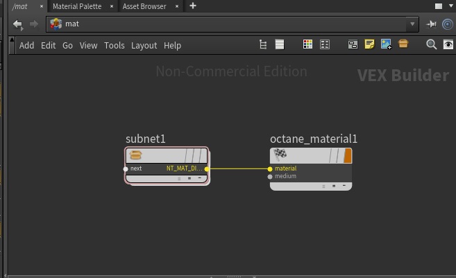

WhyGee wrote:follow up question:
with the mantra shaders it's possible to have a material network in a subnet and have the material as an output of the subnet. Is this possible with octane?
Something like that? Yes, it should work. And a full subnet with the OUT Material inside also should work.
Thanks,
-Juanjo

I see I thought the workflow requires the use of Parameter export to do that, like in Kai's mantra 16 tutorial.
Thanks again!
