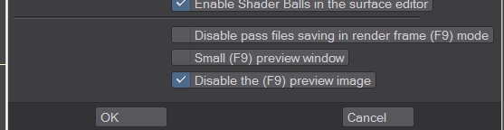

Asher, I think that the main problem with this large resolution images is related to the preview window, that needs a lot of time to get and dump the raster image, especially if the compositing functions are enabled.
For the next build, I've added an option in the plugin options panel to disable the preview image in the F9/F10 window. This should improve a lot the plugin performance while rendering large resolution images with the compositing functions enabled, and at least here your scenes can be rendered fine with this option enabled.
I am going to send you by pm a custom build to test this feature.
Thanks,
-Juanjo
