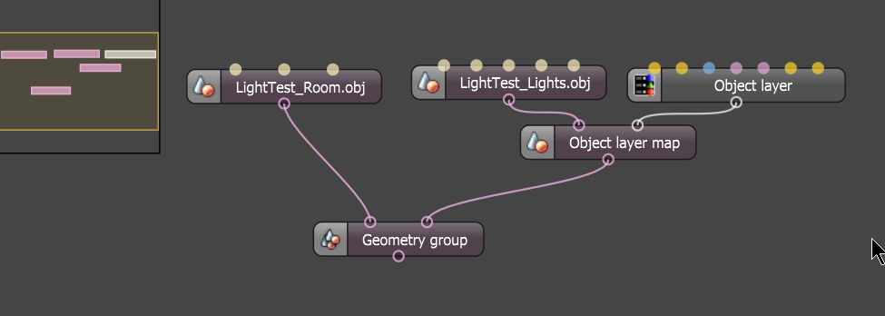

calus wrote:(also why did you remove the render target from the orbx ? was not easy to find back your camera and settings)
Click the RenderTaget Node button.
lol
Again, there is no rendertarget node in your ORBX, no camera node, no kernel settings.
But nevermind, As I said I get around that and found that as your lights overexpose the scene a lot,
you must have lower the exposure without lowering expected exposure at the same time,
the reason why you have this result.

calus wrote:Again, there is no rendertarget node in your ORBX, no camera node, no kernel settings.
Yes there is :) Click on "Geometry Group" to start the render. Then you have all the settings in the Node Inspector.
So you don't use any rendertarget but the preview of the Geometry Group node, ok why not.
Finally this has nothing to do with expected exposure, but I don't see any problem either,
you have high noise treshold0.05 and a gamma of 0.9
So the result is as expected, a part of the noise you see is the limit you defined and is made more visible because of the tone-mapping,
Also most of the noise is just because you need a higher max samples than 7500,
to finish to clean all the non-green area of the noise map.
