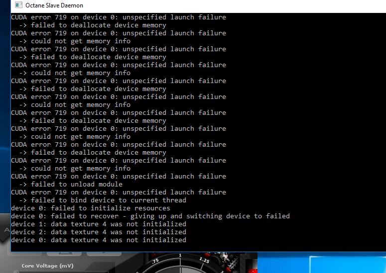

ok. I installed version 376 and for a few minutes slave was rendering fine.
So I was happy - but only for a short moment.
Some minutes later same problem again!
No chance to decrypt these messages?
GPUs are getting hot (about 86°C) but then normally GPU throttles down.
Does this maybe cause the slave to crash?
But whats about these messages like "date texture 4 was not initialized",
"failed to initialize resources", ?
hmmm
Mike
