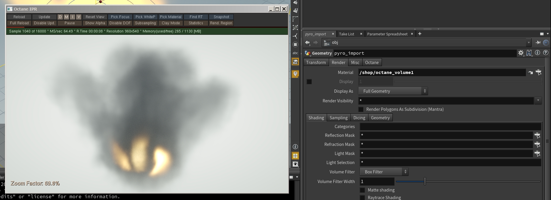

Just one little question : is it normal that materials for volumes should be set up a sop level (when using the medium port of a shader) ?
The object render material tab is useless in that case.

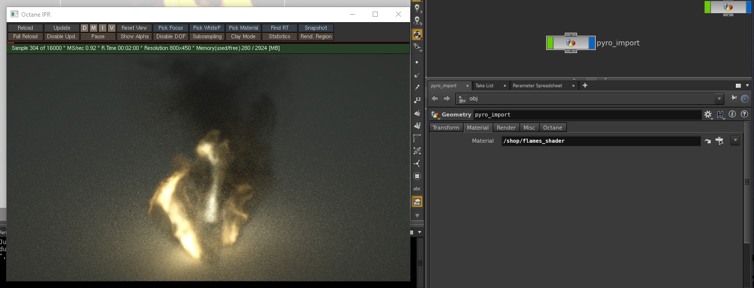

Weird, I'm always working with the volume material set at OBJ level without problems so far. Can you send me a sample scene with this problem to test it here?
Thanks,
-Juanjo

Juanjo your image is not H16 right ?
We don't have the material tab anymore, it is embedded in the render tab.
Thx
juanjgon
Posts: 8867
Location: Spain
Yes, it is an H15.5 capture, but in H16 the parameter has the same name, and it seems to work fine.
Thanks,
-Juanjo

Ok thx, can't use it here.
I will send you my scene.
