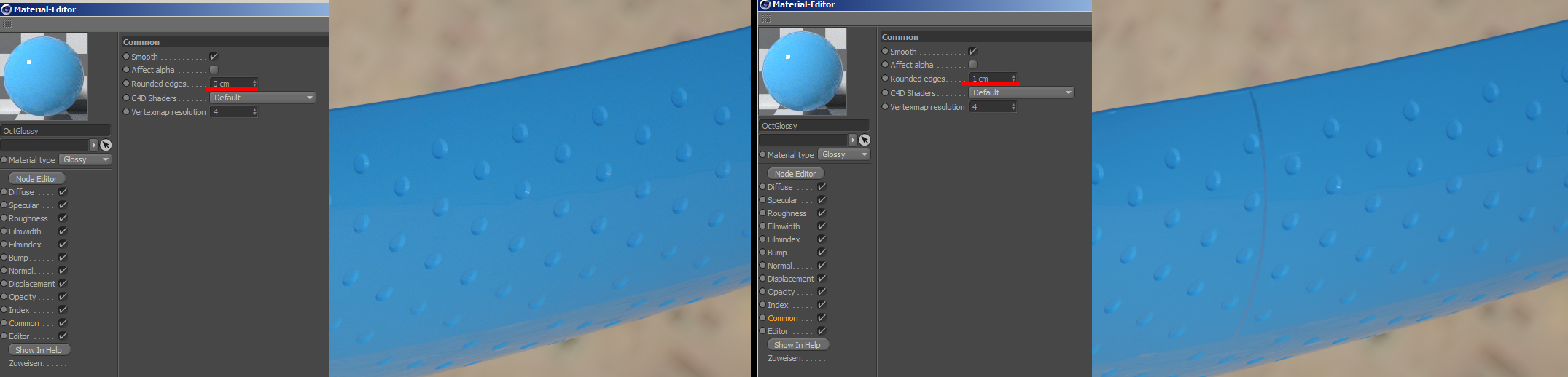

funk wrote:While it's great you found this bug, it's not related to the 2 screenshots I uploaded. I don't think it's going to make a difference to the cylinder artifacts in my screenshots.
You are right, this is unrelated.
funk wrote:The artifacts seem to happen when triangles are closer together, but I'm not completely sure.
The artifacts you see will happen when adjacent primitives differ significantly in size or the rounded edge size is big compared to the geometry size. I know is not always possible, but in order to avoid this, your primitives should be as big as possible in relation to the size of the rounded edge (which is always in meters). Also, as I said before, as this implementation is still geometry-bound, so there's no much room for improvement, although we have ensured to reduce all discontinuities in the normals along the surface as much as possible.

funk wrote: While it's great you found this bug, it's not related to the 2 screenshots I uploaded. I don't think it's going to make a difference to the cylinder artifacts in my screenshots.
Right, I get it now.
I guess your example is not really artifacts finally, but showing limits of the round edges bias in a path tracer like Octane.
With more vertical subdivision and a more reasonable rounded edges width, it seems it should be fine.
I think it's relative to the "shadow terminator" phenomenon, hard to avoid for a path tracer, http://blog.irayrender.com/post/2904227 ... terminator
(hard but not impossible according to Thea render, but it's another story).
I bet Modo's renderer also have a way to bias the "Shadow terminator" ;)
