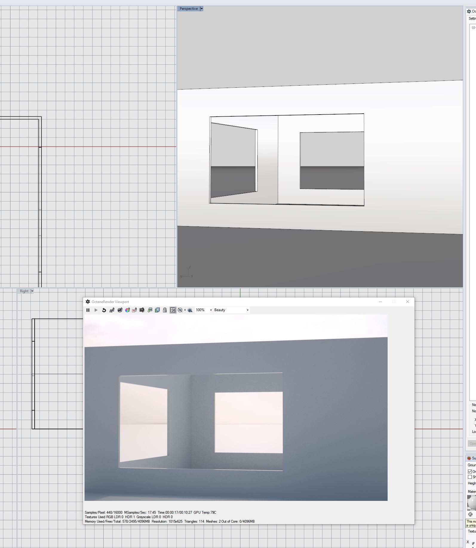

Im also struggling with cameras and viewing angles, and it's really hurting my workflow with photoshop postprocessing when doing archviz. I've updated to the latest version but Octane, unlike Rhinos native renderer or Vray seems to change the FOV based on the rhino viewport proportions. This means every time the Rhino UI changes or window resizes, I loose my exact Camera angle, even when working with locked resolution and rhino named views.
Here's a screenshot.
Octane 3.4.4.74 | GTX 980 4GB | 16GB RAM
Hi
I usually use separate floating viewport that I do not touch to avoid res changing.
Regards,
Mac
Regards,
Mac
Hi - have you tried unticking the "Sync Octane FOV to Rhino FOV" option in the rightclick menu of the Settings tree? Doing that will allow you to manually set the Octane FOV and stop Viewport size changes from changing the FOV.Im also struggling with cameras and viewing angles, and it's really hurting my workflow with photoshop postprocessing when doing archviz. I've updated to the latest version but Octane, unlike Rhinos native renderer or Vray seems to change the FOV based on the rhino viewport proportions. This means every time the Rhino UI changes or window resizes, I loose my exact Camera angle, even when working with locked resolution and rhino named views.
