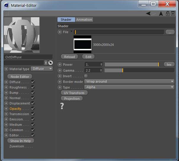

Thank you, but this is not an option. If I have to produce an overlay over a mix texture, I have to use alpha - and a lot of my work consists of moving around layers with png as texture (with alpha).
Sometimes it works now, sometimes it doesn't. Is it maybe possible to change the refresh rate in the node editor (files are always saved)?
Another thing: if I use a png with no boundaries (e.g. the cutout picture reaches the border of the png), clamp value doesn't really work as it should and starts stretching. If I change it (so that is some pixels around the content), it works. Still hope thats an error on my part - was working some versions ago.
Here's a file (used psd, doesnt make a difference): same settings
- Attachments
- test_borders.rar
- (96.22 KiB) Downloaded 324 times
mrom, i think you should use black color in border mode.
I can't see any issue on plugin side. We just transfer parameters to renderer. I couldn't feel any issue on behaviour of modes.mrom wrote:thank you for your answer, but this was just an example. normally, my pngs do have a bit more colour
so is it a limitation that there should be a strip of emptyness around the actual content of the image texture?

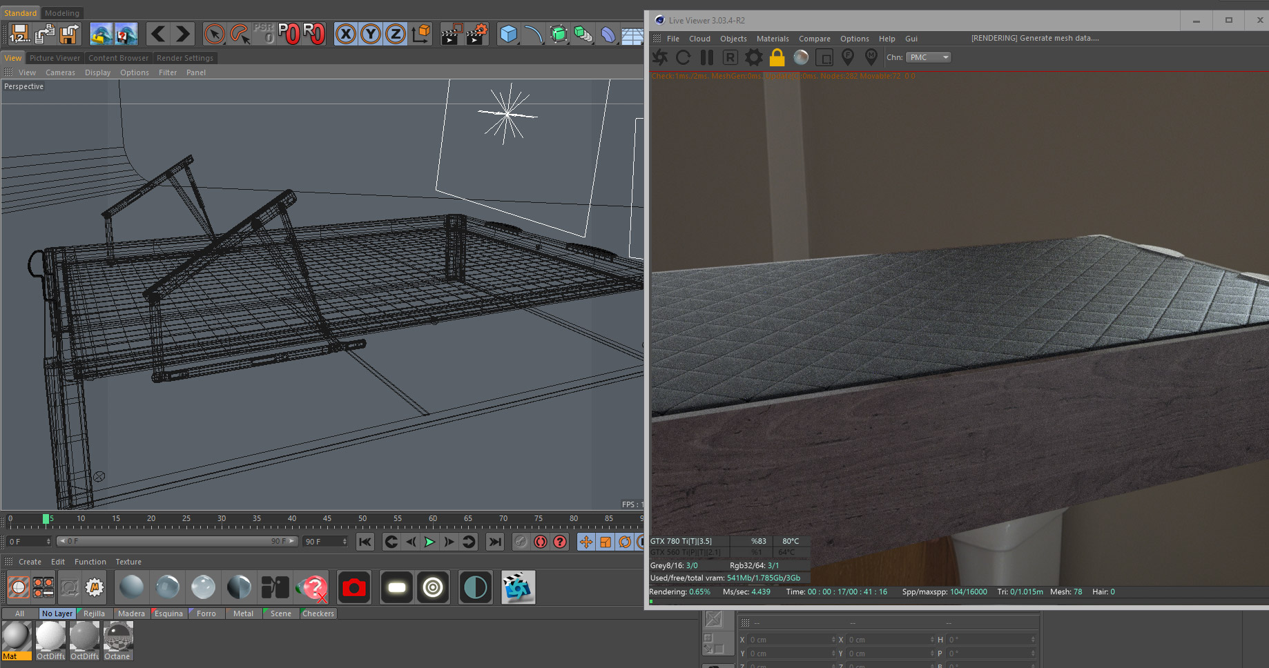

You should see percentage numbers in values as in image.
- Attachments
- a1.jpg (12.83 KiB) Viewed 5678 times
