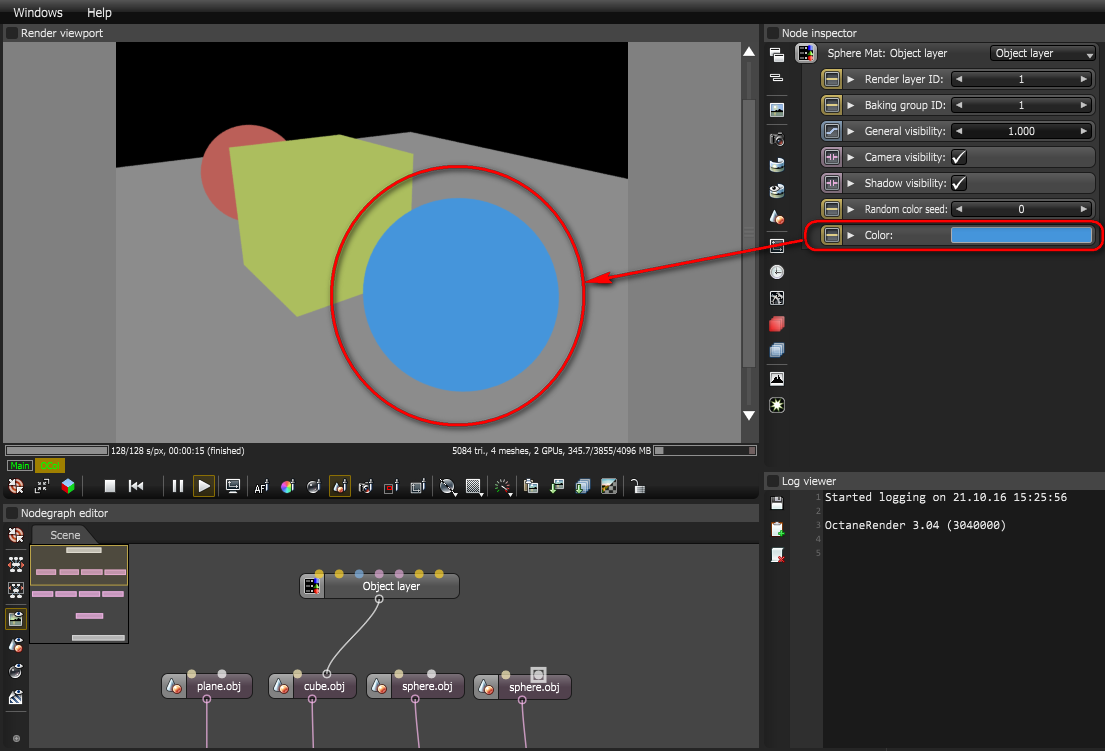

oguzbir wrote:Hey abstrax,
While you start dealing with the info/render passes or Render Elements as we call them in 3dsmax.
Could you please implement Material or Object ID passes with colours only with R G B colours..
you can read more about this need here:
viewtopic.php?f=82&t=56981
You can do this already using the object layer node, where you can specify a colour, which is rendered in the object layer colour pass:
