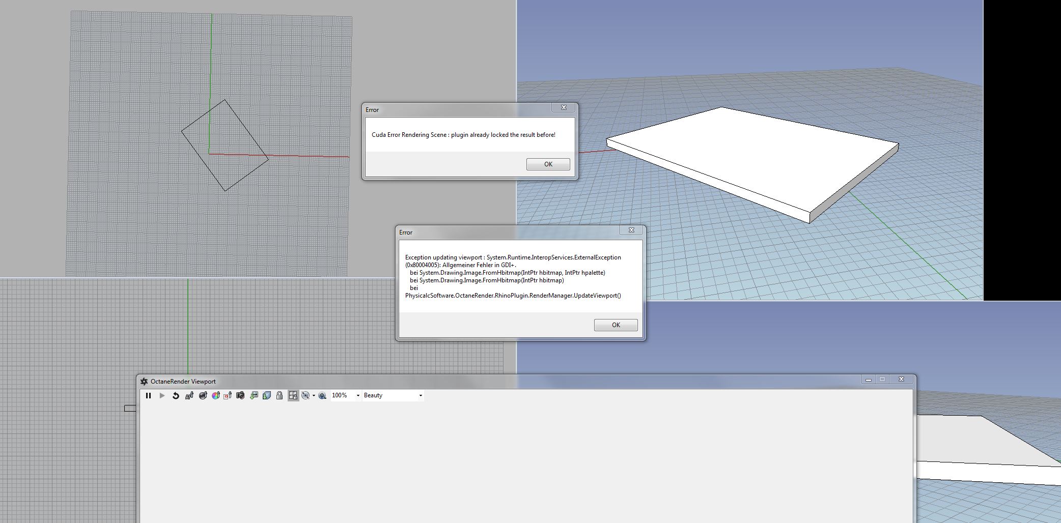

I was working on a large scene, rendering a hires panoramic image. Suddenly the scene stopped rendering, the attached dialogue windows appeared after the voxelization phase, I think the last thing i did was changing the resolution while rendering. I deleted all geometry and loaded the octane default settings -> still crashing... attached please find the screenshot of the error message and the stripped down scene.

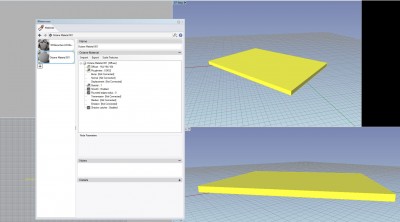

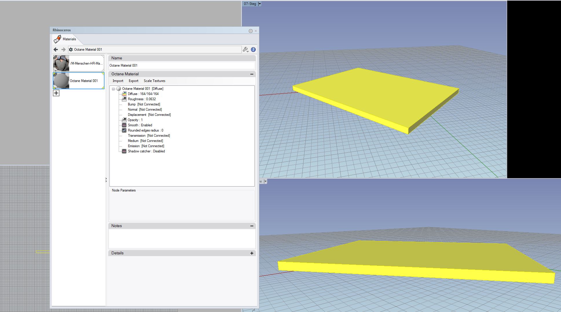

P.S. another thing I observed several times before in other scenes: If you look at the second screenshot, you can see that despite purging several times, there is still a unused material in this scene - do you know why ?
P.S.S. another thing : this scene is huge ! although it only contains one polysurface box, it is 30 MB... something is definitely wrong :-)
I thought this had been fixed in a recent release. Which version of the plugin are you running pls?
Is it possible the unused material belongs to a layer?
Also worth noting on that scene is that if you click the Perspective View, you can see the Rhino Camera coords are corrupt (the Octane Camera is translating them to an Up Vector with "Not a Number". I've seen this before, and found the solution was to create a new Perspective viewport - which will not have a corrupted Rhino camera.
