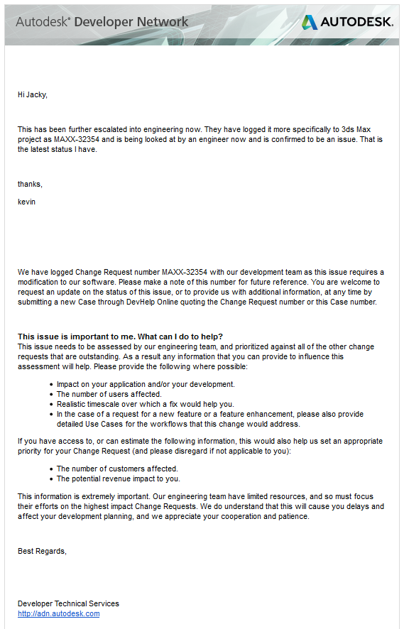

coilbook wrote:I am afraid this will take years to fix since noone has even contacted autodesk yet to begin the process
This is wrong. As I already wrote on the forum, I opened a ticket at Autodesk a long time ago, there was no reaction from them (the ticket number has been posted on this forum). So there was no additional info for you on that case.
But happily, today they've finally sent a meaningful answer to our guy who has been trying to push on them all this time... It is confirmed that this is a bug in Autodesk 3ds Max application (as I've been explaining from the beginning). Now let's hope that they'll fix it in some of next service packs...

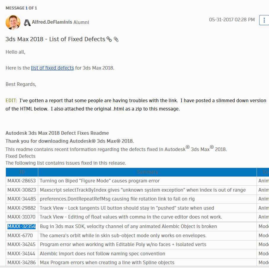

this bug was fixed in 3ds max 2018. can someone check if motion blur is working?
r9 3900x/64Gb/2070s/2070/win10x64/3dsmax2021
coilbook
Posts: 3125
mikinik wrote:this bug was fixed in 3ds max 2018. can someone check if motion blur is working?
Hi it is working fine
mikinik
Posts: 221
Joined: Sun Oct 07, 2012 1:05 am
Hi, coilbook! Wow, great! Finally! I'll celebrate.

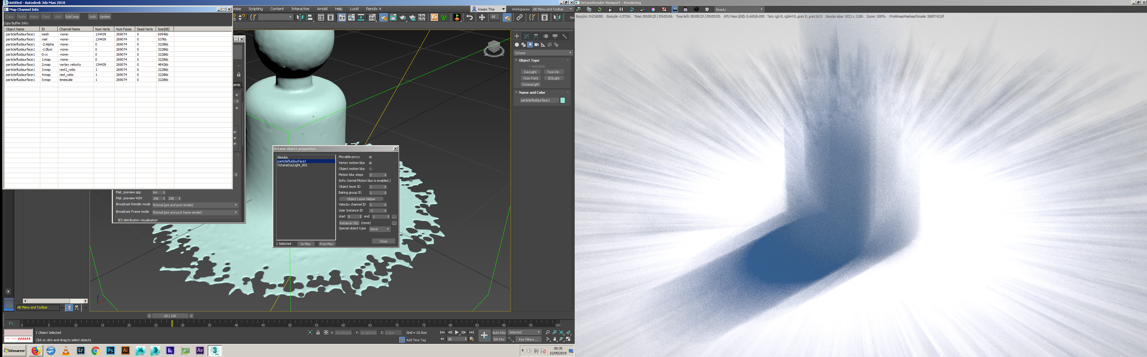

Sorry but in my case abc files from houdini with velocity channel don't work with motion blur in octane ...
