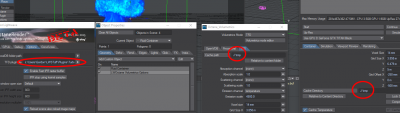

Hard to tell from your path, but is that pointing act the TFD plugin? If so, I've done that.

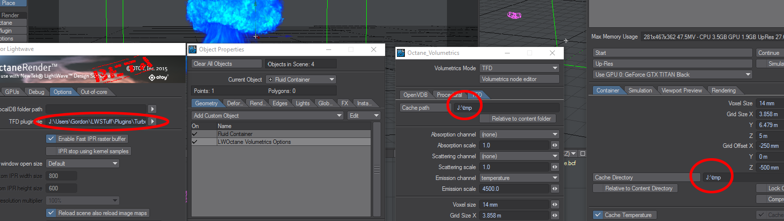

here are settings

It must point to the TFD plugin .p file, for example: "M:\C-Octane\TFD\TurbulenceFD_LW_v1-0_1401\TFD_loader_64.p"
Doesn't work for you?
-Juanjo
gordonrobb
Posts: 1247
Joined: Sat Mar 16, 2013 9:08 am
that's what it's pointing at yes. NOpe doesn't work. There's an update available for my version of TFD though, so I'll try that first.
