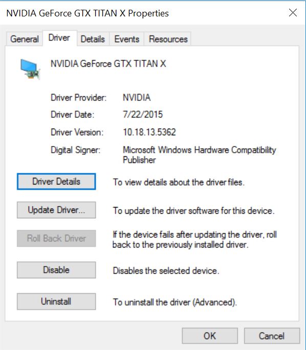

It's an issue with the drivers!!!
I uninstalled all the Nvidia drivers (HD audio, etc), and it works. I'm using the driver that was included with Windows 10.
If the file isn't visible, it's Driver Version 10.18.13.5362 dated 7/22/2015.

In case it isn't obvious, driver version 10.18.13.5362 dated 7/22/2015 is GeForce driver version 353.62.
Can't play Battlefront with that driver. Trying 358.50, minimum for that dated Oct. 7.
