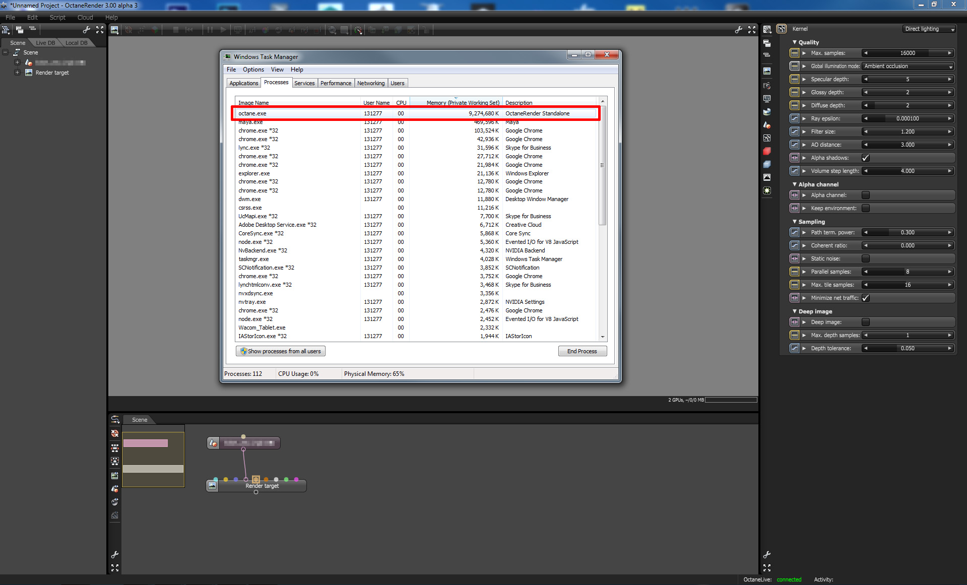

abstrax wrote: Only 8GB for more than 40million triangles sounds too little, but I guess there is a bug somewhere in the geometry compilation. Could you send me the scene? Thank you.
I tried again and waited a little bit more, but the memory keeps raising, and the PC becomes unusable, even the mouse freezes sometimes...
I sent you a PM with the link.
abstrax
Posts: 5516
Thanks a lot for the scene. I just tried it here and Octane very quickly runs out of memory on my box. I've got 32GB installed and I stopped the compilation as soon as Octane hit the 28GB mark... So I don't know memory you would need for this thing.
We are currently looking into the geometry compilation anyway, but I'm not sure how much we can do about it.

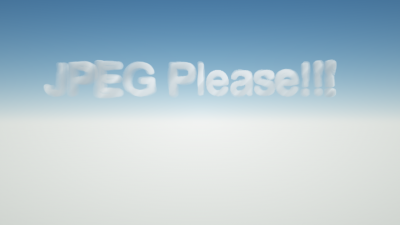

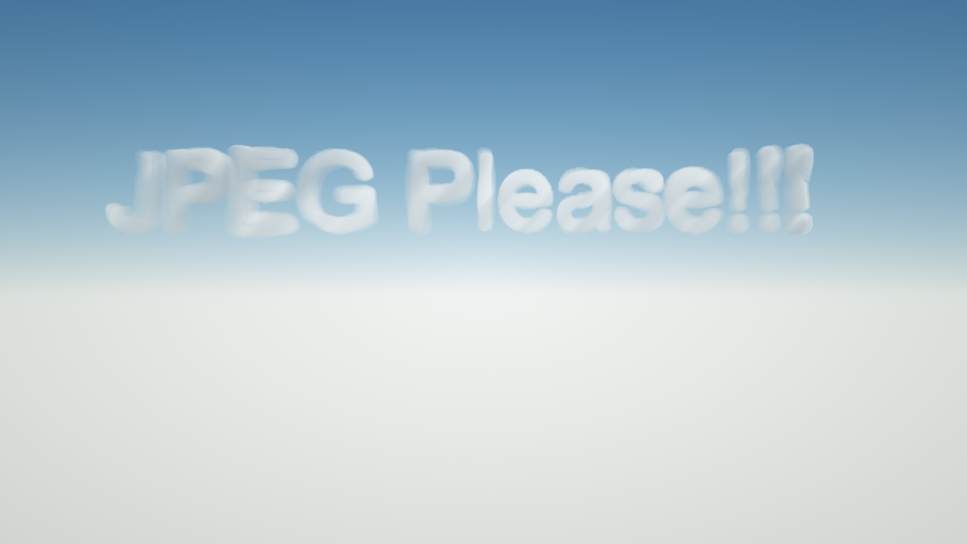

Okay, but the big question still is are we getting the JPEG option...
I know it's only of 'medium' level concern with a low 'volume' of users asking...<br />Get it ?!!!..
Get it ?!!!..
Seriously having too much fun with this...<br />thanks again for letting us trial V3 :)

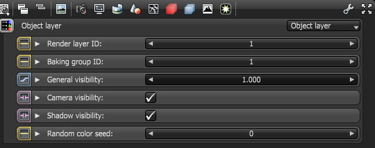

A small bug - when 'O' for picking mode is used to selected any geometry that has an active object layer pin, all settings for obj are gone (only the object layer is shown) - see the screenshot. I have to manually select an obj node from the node graph to access geometry settings.
