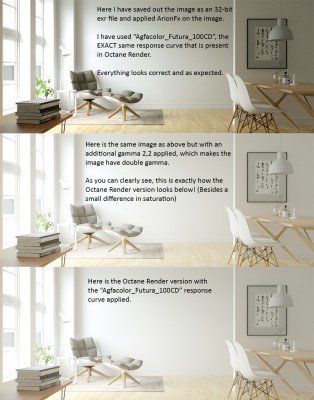

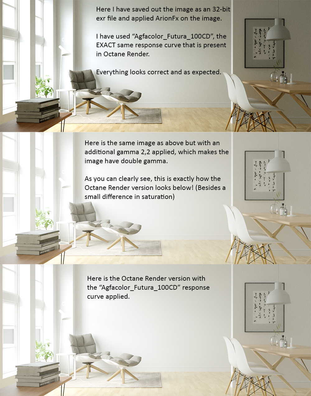

Hi Jim,
I´ve done some more tests. If I´m thinking completely weird, let me know and you can then delete this post :)
Perhaps this should be posted in the standalone part of the forum, if so, let me know and I will make a post there.
I still stick with my earlier rant about double gamma. I think the image I´ve attached explains it pretty good. If you need more information from me, let me know!
I think it´s great that the gamma is working as it does in the Standalone version, BUT this is the 3Ds Max plugin version, shouldn´t the plugin version be adapted to work correctly with 3Ds Max?
If I wanted to use the Standalone version, I wouldn´t have paid extra for the 3Ds Max version!
I of course bought the plugin version because I wanted to use Octane in 3Ds Max and thought that the plugin would be implemented to work based on the specific 3D software...
Gamma Issue
Gamma Issue
