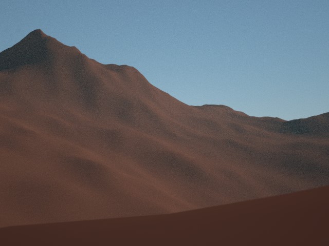

It looks like you have not increased your medium radius to take in the scale of your scene. Note that, as you increase the medium radius you also need to reduce the power of your medium shader. I have found no difference between the way this and the previous plugin version behave so there must be something you have not set in your scene.PhilW wrote:Thanks for the info - the emitter effect sounds like it might be cool and very useful.
I have attached an illustration of the "flat fog" in the environment medium, there is no sense of it receding as it is applied uniformly across the whole image. In the previous original version, I was able to get good receding atmospheric haze in a scene like this. I am just guessing here, but maybe this is done by having an inward facing "bubble" around the camera, and somehow the normals on that have got inverted?
Win8/64, I7-4770K (3.5Ghz) 24GB, GTX-980ti (6GB) / GTX-TITAN (6GB)

The way atmospheric medium works is by having two spheres, one around the camera with inverse normals and one that contains the medium. You can set the size of the medium sphere and you should set it to enclose the area that you want the fog to cover. You then need to set the medium. Setting absorption to black and scatter to white will give you white fog. You then need to adjust scale to get the effect you want. The larger the medium radius, the more the distance fog effect will be seen. If you are pushing the limit of the scale value then you should reduce the scatter color to a darker gray.
Ah, hah! The light goes on - thanks for the explanation of how this works! I must have just been lucky with my settings first time around. This is an image with a 1000 feet square terrain, 1000 m radius on the environment medium (would it be a good idea to set this in feet as well for consistency?), and Medium Scale of 0.01 with scattering a mid to darkish grey slightly tinted towards sky blue.
