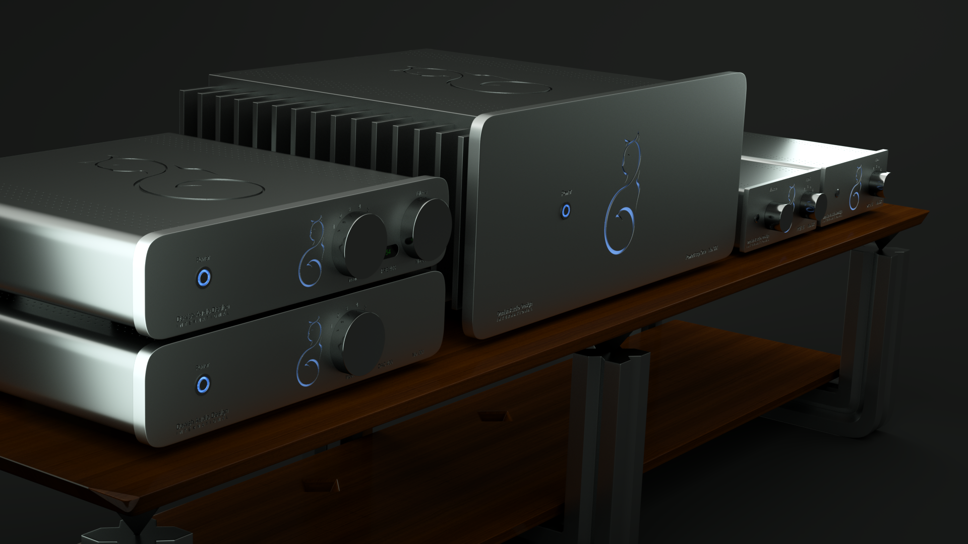

Running NVidia driver version 358.50 as it's the best one right now for Windows 10 as far as I can tell. Newer ones crashes the display driver.
Also it seems to me that the displacement shift option is a bit funky. It seems the displacement doesn't respond to it being changed. I've attached a pre-3.0 render and a 3.0 IPR render of the same image. Sorry for the dark image - hope it's viewable.
Octane 3.0 Displacement
Octane 2.2 Displacement

Bitboy wrote: Also it seems to me that the displacement shift option is a bit funky. It seems the displacement doesn't respond to it being changed. I've attached a pre-3.0 render and a 3.0 IPR render of the same image. Sorry for the dark image - hope it's viewable.
I need to check the displacement shift parameter, and see if it needs a conversion function for the old scenes. I think that Octane 3 has changed it's behavior.
"Displacement
The UV map in the displacement texture is now taken into account. The "shift" parameter in the displacement node has been replaced by a new option "mid-level". The old parameter defined the shift of the displacement in meters, while the new parameter defines it in texture value range. So if you for example have a Zbrush export that has 0-displacement defined at 0.5, you set the "mid-level" to 0.5 and can then scale the displacement height independently. Should be more convenient than the old system."

juanjgon wrote:I need to check the displacement shift parameter, and see if it needs a conversion function for the old scenes. I think that Octane 3 has changed it's behavior.
"Displacement
-Juanjo
Thanks Juanjo! Love your work on the Octane plugin. I'll see if I can make it work by adjusting settings some more in the Displacement node.
