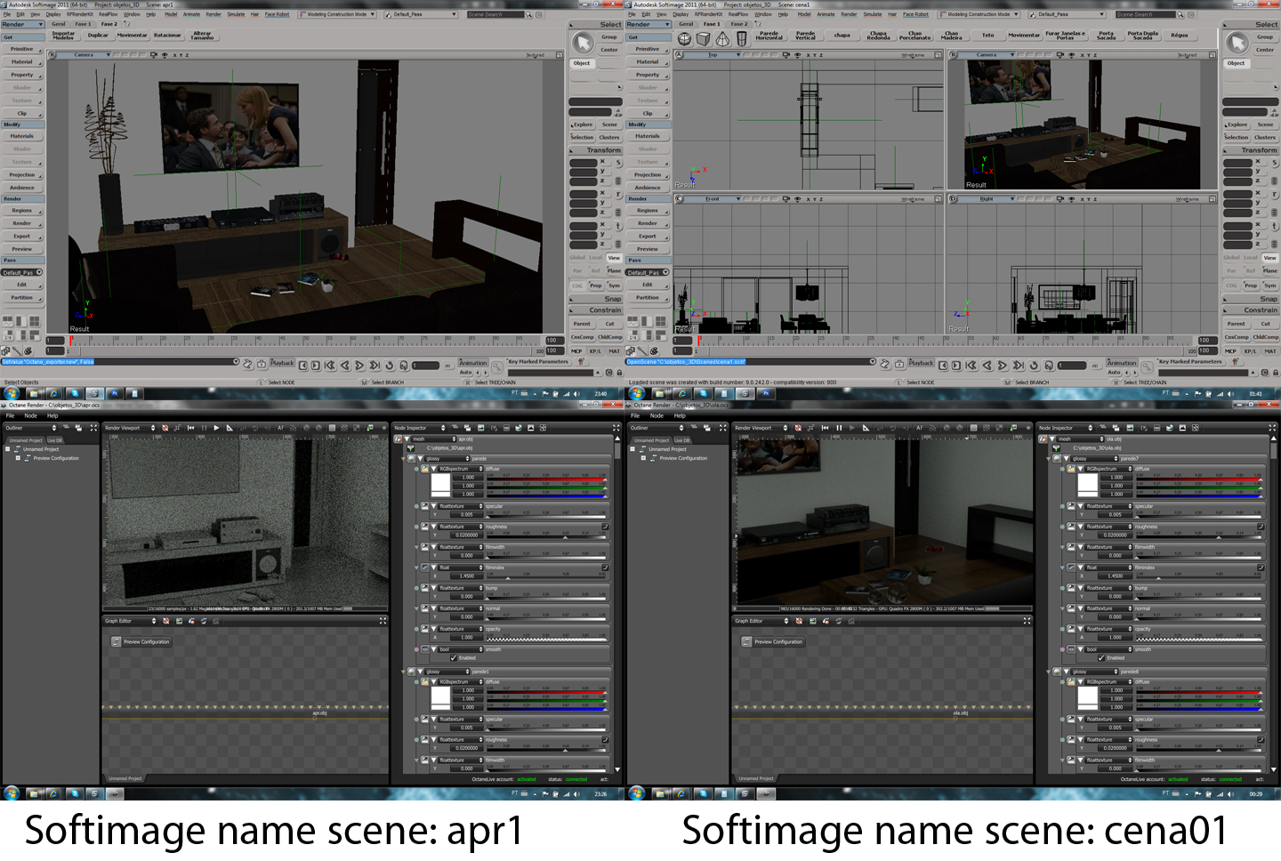

I made what you said, deleted all the .ocs files and made a new one and nothing.
I made other test and look what i´ve found, I don´t know if it have to do something with, but in this way it´s working.
When I name all of my scenes in softimage with this specific scene called "cena" it always will work, I´ve made more of 10 times the project with names, cena01, cena 02 and etc...
When I tested other softimage scene name called "apr", it never works, no matter how I try.
All of this tests was made in new projects and new ocs files.

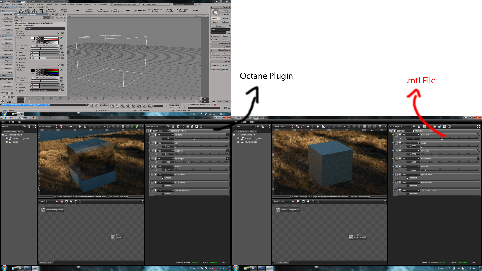

Is there any possibility of .mtl file reads the glass configuration from softimage to octane? Because the color and specular of shaders works fine, but when it comes with glass from softimage mesh comes grey.
If it´s possible, I can fix my problem using import obj mesh option in octane.
Windows 7 Ultimate 64-Bit, Intel I7 980x Extreme, 6GB ram, Nvidia Geforce GTX 580
Glas should be if the material have an IOR > 1 and the scaletrans is > 0.
Thats the rule, so I write it in the mtl-file.

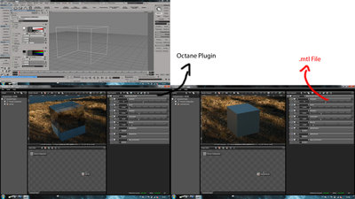

Face, look what it happens.
Am I doing it right?
When I export with octane exporter, material comes with specular and when I open the scene with .mtl material comes with glossy.
I just need to make this glass material works and my problem will be totally fixed, i will always open .mtl file instead use octane exporter.

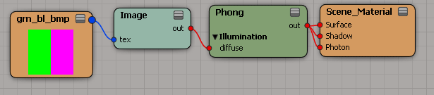

For the textures I´m looking on the "txt2d-image-explicit" node as the input node for any texture.
If you have a mixnode or others in the diffuseport, it doesn´t works.
The rendertree should looks like this: The resulting mtl-file I become is this:
