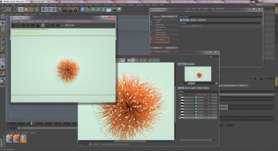

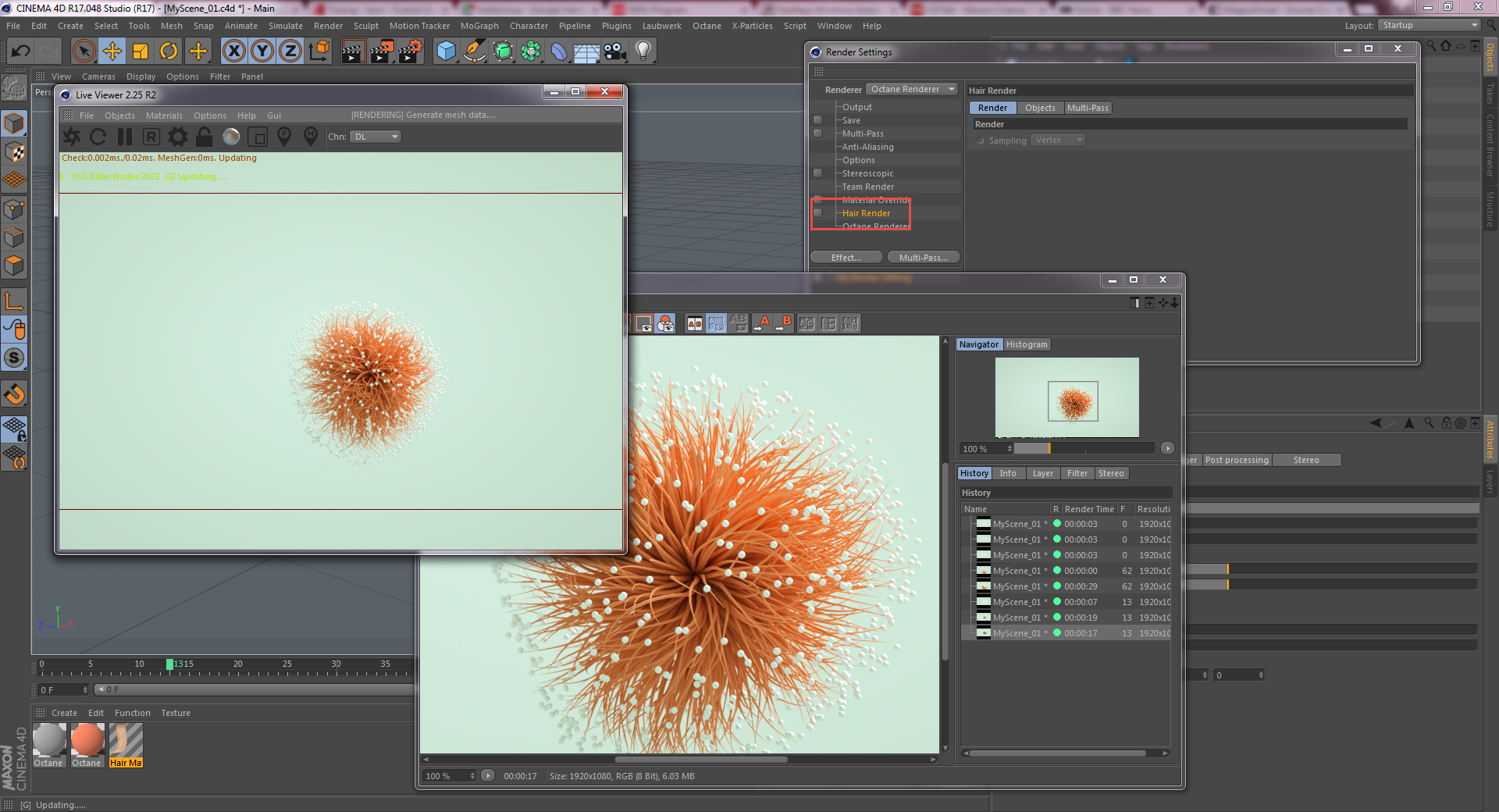

Hair via X-Particles Not Updating In Render
Posts: 16066
Location: Türkiye
You should disable "Hair render" in settings. Things are changed on latest versions. I know that's weird but it makes conflict to read data. I'll take a look for next versions to find a fix.
