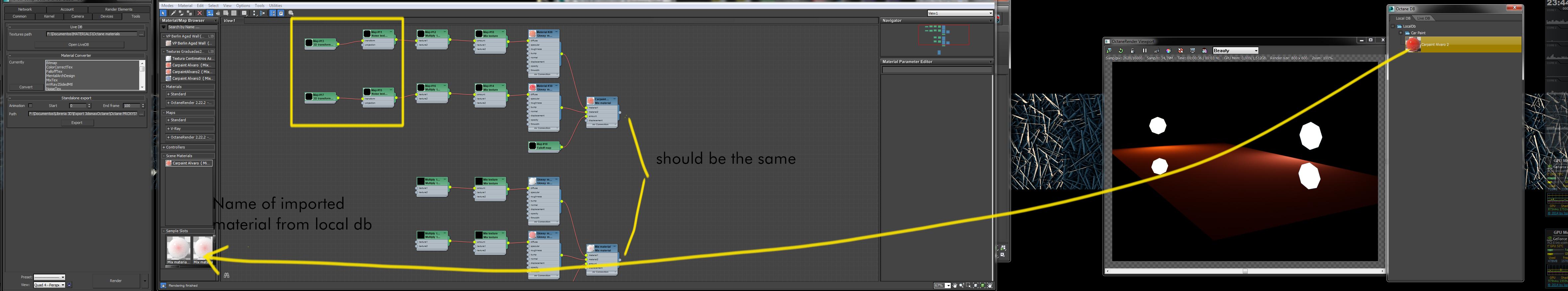

Hi Jim.
When a material from local db is imported to max, some nodes are missing, and the name of material ...the same material in standalone works fine.
PD:in standalone is possible change the path for local DB...but here in max I can´t ..is Always ...users/xx/AppData/Roaming/OctaneRender/localDB..
my primary drive don't have much space for keep materials on it.. :cry:
JimStar
Posts: 3852
perro_abombao
Thank you for report. Will check it. Looks like the plugin does not know about Octane noise texture so far...

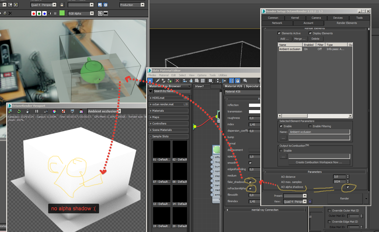

Goldisart
Posts: 780
Joined: Sat Oct 26, 2013 8:47 am
no work AO Alpha shadow

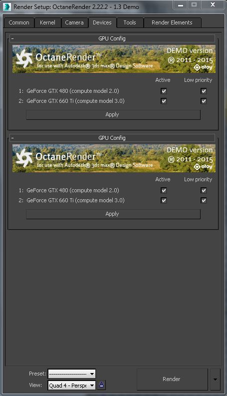

Tugpsx
Posts: 1180
Location: Chicago, IL
Not sure why the device tab shows 2 sets of cards in the demo version.
Demo device issue
Demo device issue
JimStar
Posts: 3852
Tugpsx wrote:Not sure why the device tab shows 2 sets of cards in the demo version.
Yes, I've seen this before.:)
This is a very old bug existing in prior versions - e.g. if you have render settings opened and change the render type combobox in Max render window, you get this doubled every time... Close-open the render-settings and all is OK again...
I'll have a look at it in later versions...

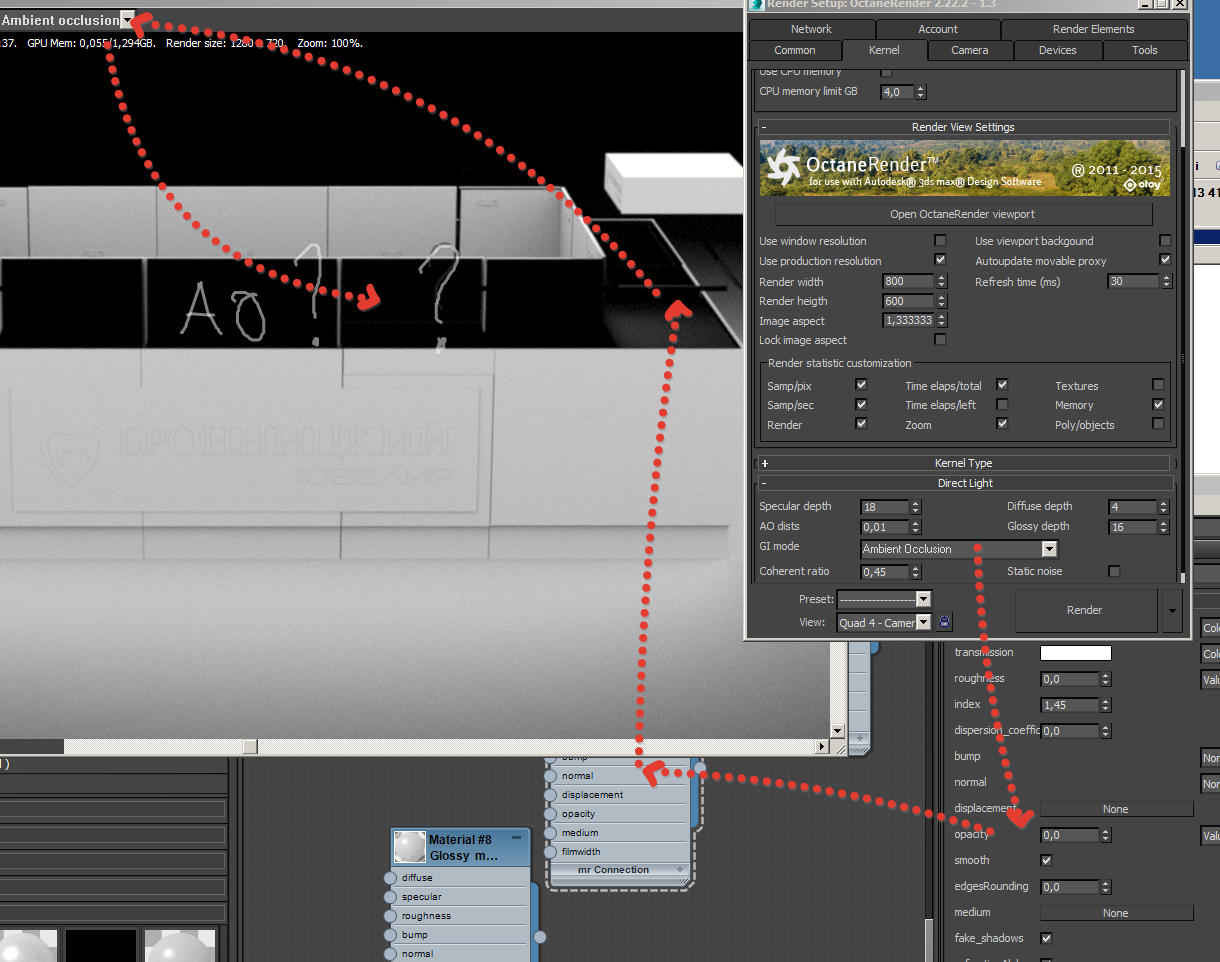

Goldisart
Posts: 780
AO problem
hi - I have a big request is even possible to make the slider to add intensity to the AO to make an additional pass render elements THANK you

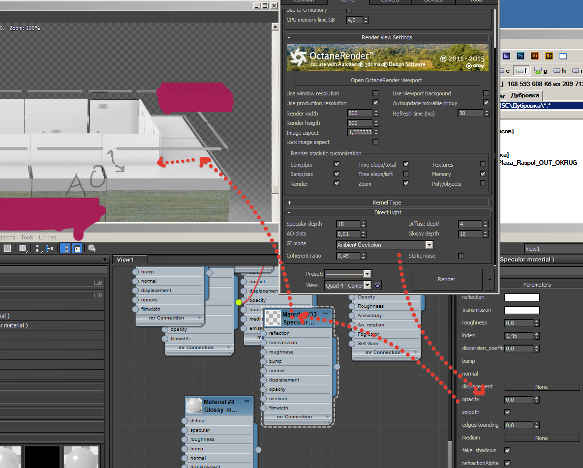

Goldisart
Posts: 780
