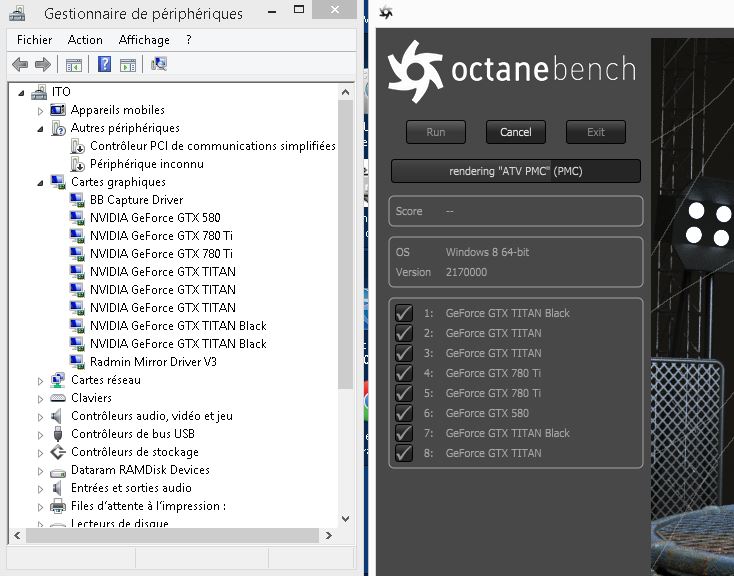

That means you have 9 GPUs and 2 types of cards.
I don't think that a power problem as I have 1600 PSU for titan black an 780ti and 580GTX. and another 1600W on the main system with the 3 other titan.
All are water cooled and get max about 40°C on octanebench.
I think about a lake of IO mem on my BIOS. I have 4 types of cards. I will try to free up some IO by disable some device. Or if I could find one more same type of board ?

Yes ! and a score of about 775 on octanebench.
They are all stable on windows 8.1 64bits.
Tried on windows 10 but no drivers for 580GTX.
update for power consumption : measured the input power of the whole 2 rig with a power meter :
- at standby (idle windows) : 320W
- at full octanebench : 1788W (up to 2000W peak for 1 or 2 seconds)
As I can disable power on the external rig, I could save about 140W while only surfing on web. I think to only enable all GPU for final render, as my primary rig has already the 3 titan.
