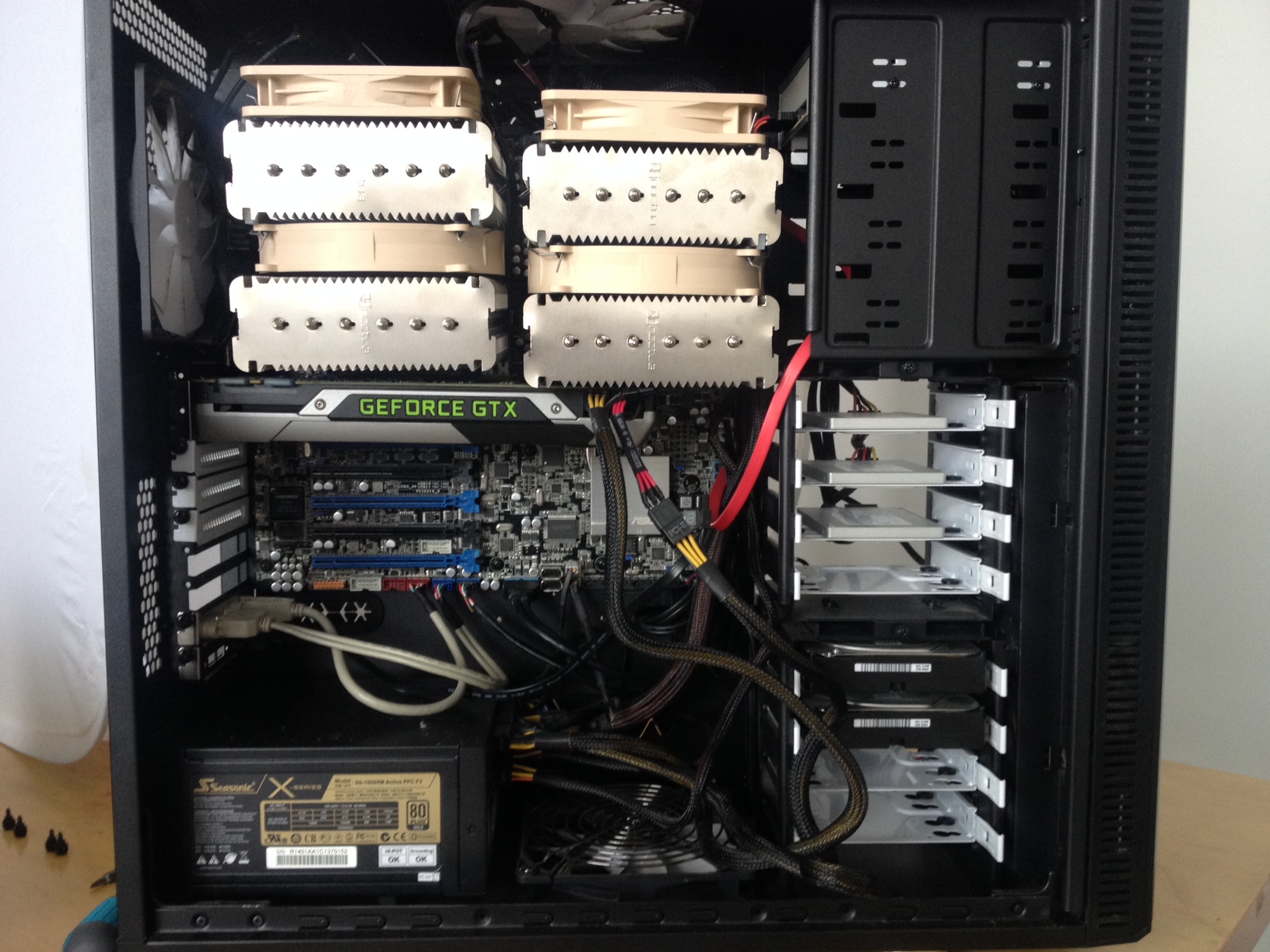

Which card as extension on a Titan Black?

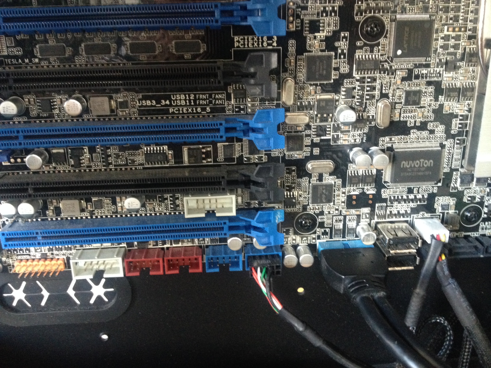

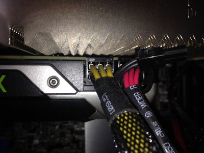

Bear in mind that all of lowest connectors are to be removed. You may also encounter some problems with chassis connectors under the lowest gpu...
So maybe I should first try to lower the Titan Black one slot downwards. If that fits, try and move the fans to the top of the Noctua's. And if that also fits, order the two 780's?

It will fit - some time ago I assembled 4x titans on such a motherboard. But first connect chassis power cables, remove usb cables and then insert the lowest card. It may happen that you'll need to bend slightly power connectors to insert the lowest card (be very careful with it).
So I tried lowering the Titan one slot into the blue slot. But the Front USB 3.0 cable (wide one with the blue socket) was in the way. I tried bending it, but when I put the card in, it didn't fit and the cable sprung loose.
Are there maybe cables which have a smaller footprint? OR should I place one of the 780 there because that card has the fans on top of the card?

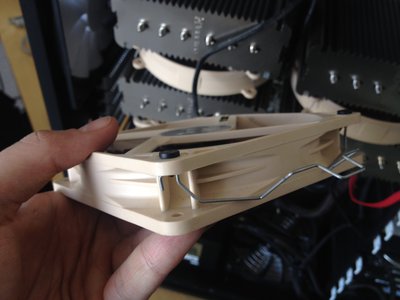

Then I proceeded putting the bottom Noctua fans to the top. So I removed them from the bottom and put the brackets and black plugs on the other side of the fan. That's how I was supposed to do it right? To keep the same airflow?
So here are the fans on top, creating more room like you guys said. Then I tried putting the Titan Black in the first slot to see if there was enough clearance created.
It's JUST enough clearance, I could lift the Noctua a bit because it's leaning down a bit through it's weight. So maybe use a tie-wrap or something to lift it up a bit?

As said earlier - remove all cables from lowest slots - including USB. Leave only chassis power connectors to power up your computer.
Get rid of these noctua bulky radiators and replace them with something smaller and neater.
Ok so that would mean no USB 3 on the front. But I could use a USB hub for that maybe.
