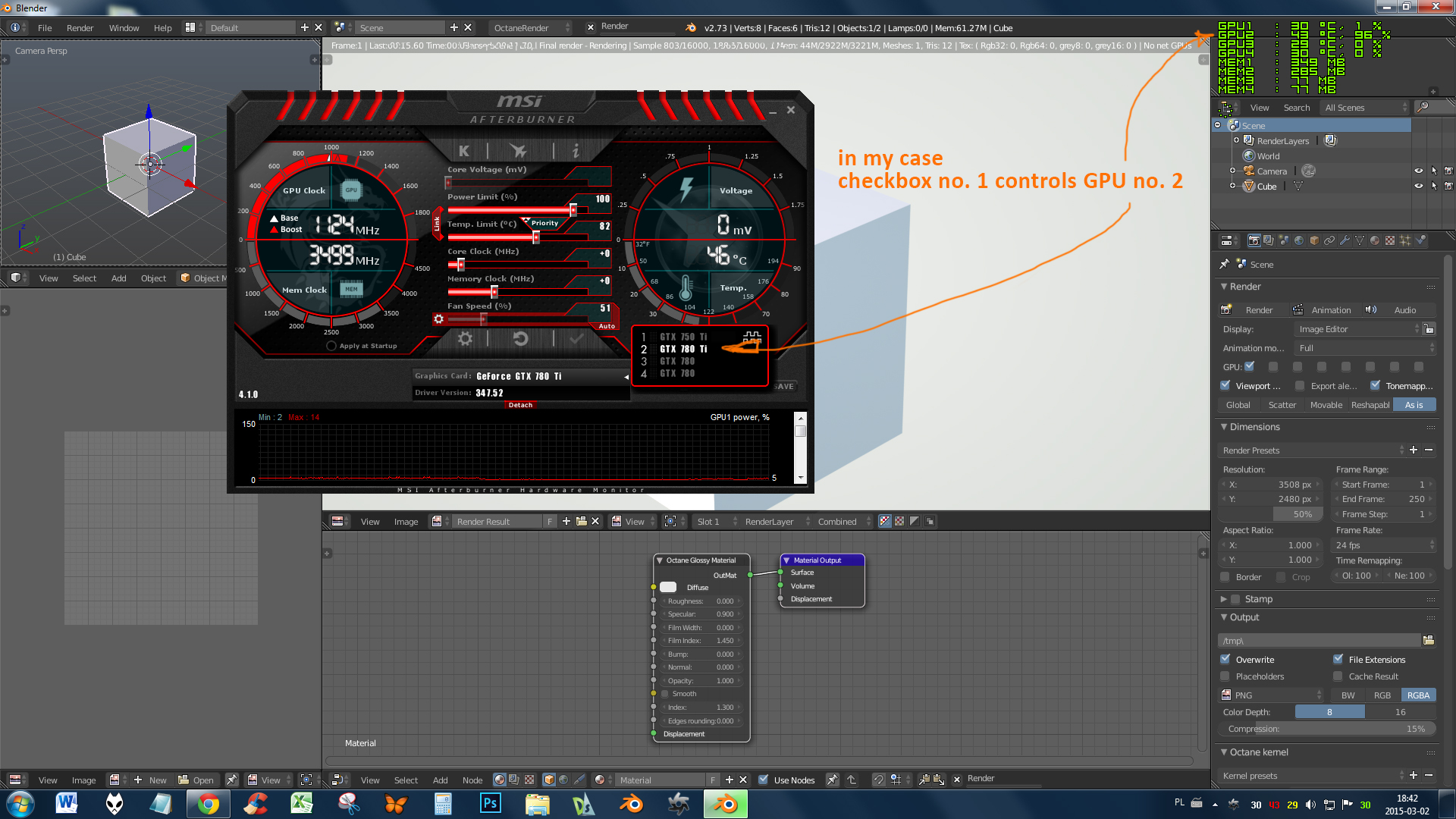

afecelis wrote:I might have my cards crossed but it would be great to have a way to know which checkmark is which card.
One method would be trial and error - check just one box at a time and look into Afterburner to see which card's being stressed. Alternatively, open the case and see which GPU gets hot. Then repeat with next checkboxes...
On the printscreen below you can see that in my case, with box 1 checked, GPU2 usage reaches 96%. Open Afterburner to see exactly which card "GPU2" stands for and that's it, checkbox 1 identified :)

Thanks a lot Kubicki3d. I was able to use afterburner to determine which card was which.
I thought the utility was for MSI cards-only but it works with any Nvidia card from any manufacturer.
I have the same situation, my GPU2, the one after the one next to the processor, works with the first checkmark on. So somehow something's switched, but I don't mind. I'm happy knowing there's a way to know which card is being used, I just hope this can be translated into Blender for Octane Render somehow ;)

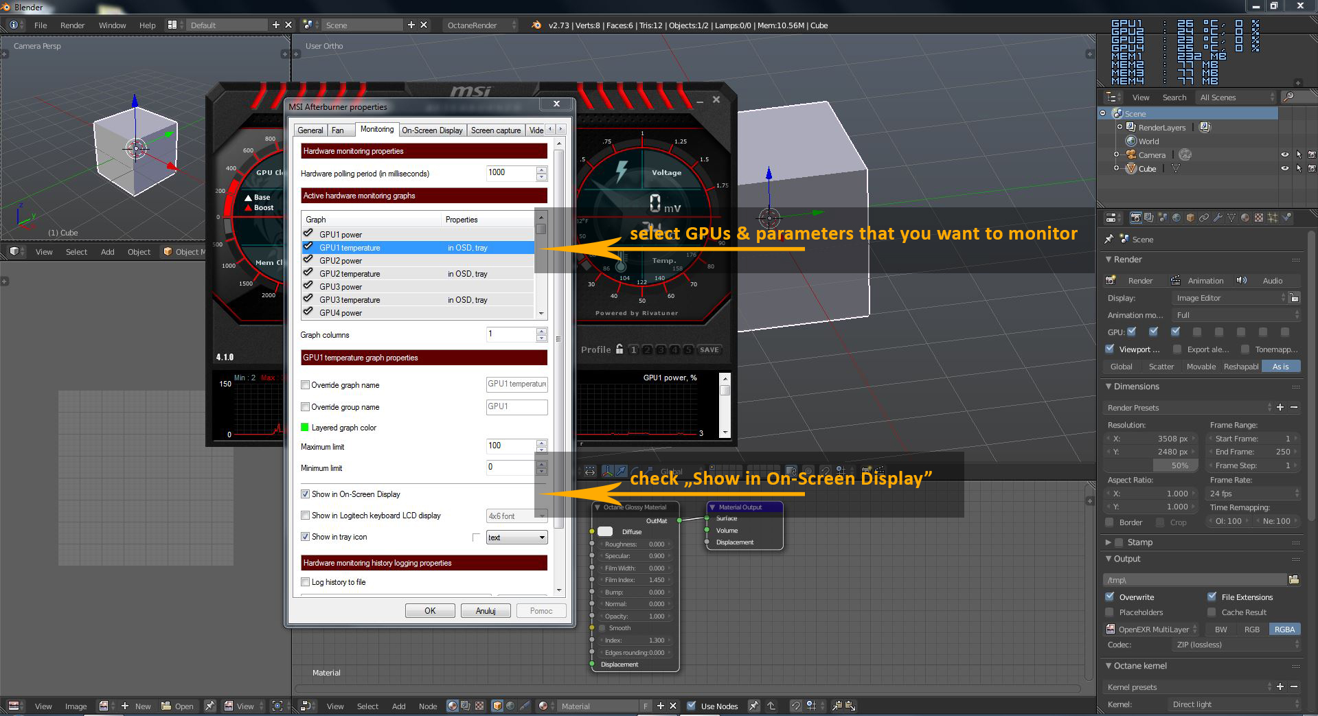

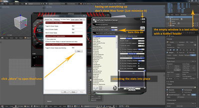

afecelis wrote:how do you get the info to display on the upper right corner of the screen?
In Afterburner, go into Properties and follow the print screens:
Not sure if I'm doing this 100% right, but it (more or less) does the job ;)

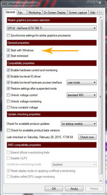

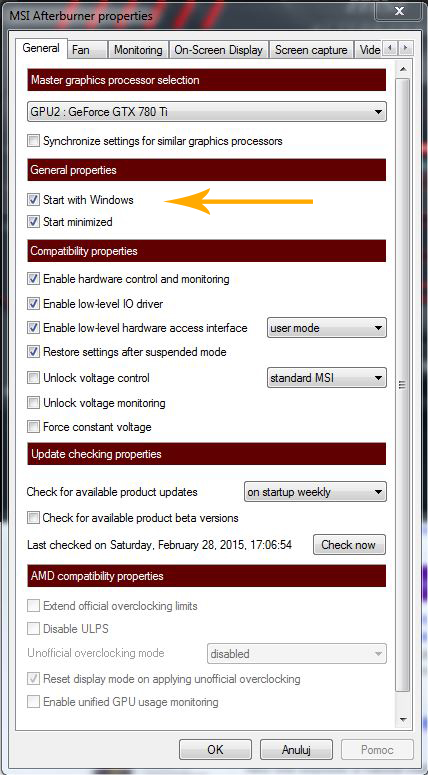

EDIT: One last thing, maybe not so important:

Thanks a lot for the detailed explanation and for taking the time of generating the screenshots (and editing them). I'll try setting it up with them, although I kinda prefer starting things up manually rather than having them autostart with windows ;)
