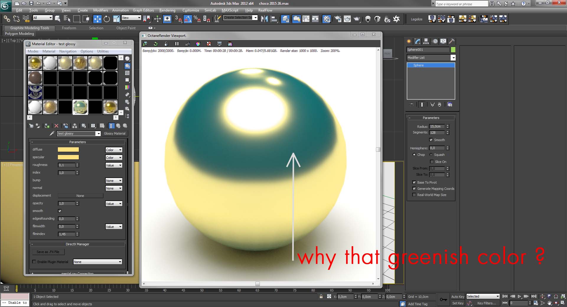

Hi Karba
Just a question I have for months about a very annoying behaviour.
Why does a glossy material react this way when the diffuse color is not black ?
I don't mean it's a bug but I would like to understand this effect and maybe counteract it.
Thanks in advance for your answer

bicket wrote:Hi Karba
this is normal. This is a physical behavior. Diffuse and specular can't have the same rgb value.
Thanks for your answer Gabriele
So I have to keep the diffuse channel black and mix the glossy material with a diffuse one.
