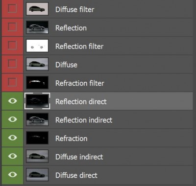

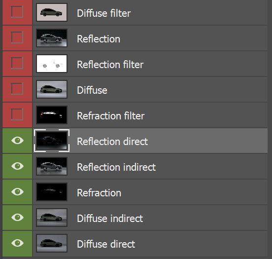

Sorry to drag this thread up again but much has changed.
Now there are a lot more passes available, i'll try to keep this concise.
The passes that are visible (green), I understand the layer order, blending mode and what I can use them for.
The additional passes (red) are what I would like to know about in regards to
Layer order
Blending Mode
and
What I would/could potentially do with those layers
Thanks in advance
C4D R20
1 x GEFORCE RTX 4090, 64 GB RAM
If you believe in telekinesis, raise my hand
Posts: 10591
the Filter passes are used if the Raw option is enabled, please, have a look at this document:
Beauty passes.
ciao beppe
