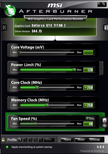

New OC numbers for those interested.
Forgive the excessive amount of pics...
I pushed power to %120, and added 250Mhz to core and memory

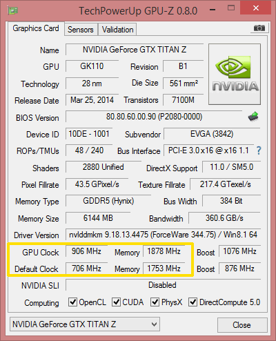

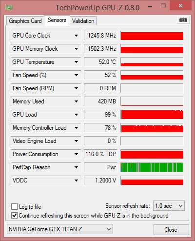

What GPU-Zs sensor was picking up under full load

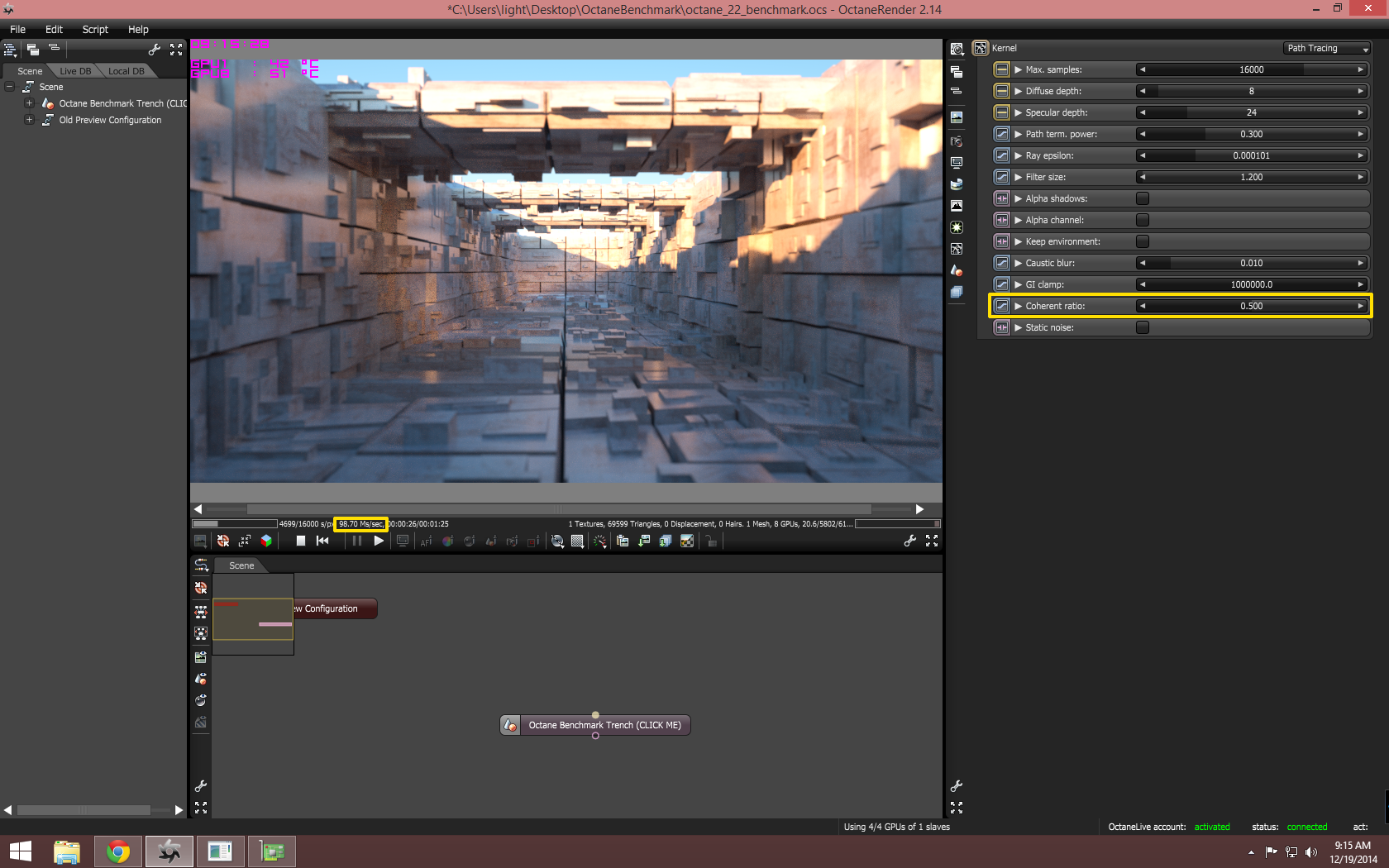

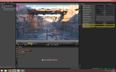

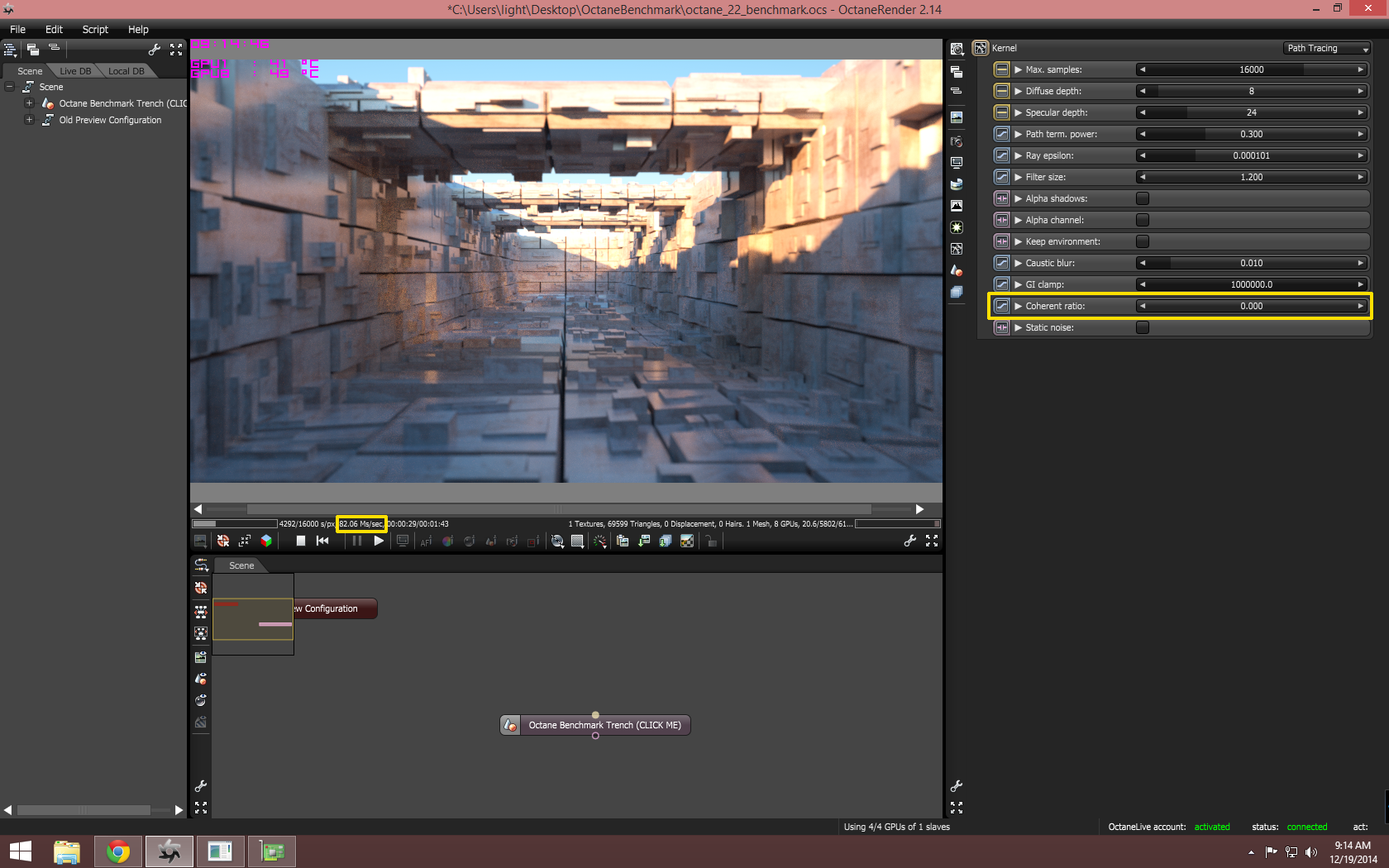

Benchmark numbers
Pathtracing
Pathterm @ 0.3
CR= Coherent Ratio
CR 0.0------- 82 Ms/s
CR 0.5------ 98.7 Ms/s
CR 1.0------ 108.94 Ms/s
After Running the Bench for ~20 minutes with fans on full blast (Still quieter than one of our workstations with a 780ti on air !), liquid temps were at 51˚C
Water Temp 1 copy.png (10.96 KiB) Viewed 8641 times
GPU temps were between 60-73˚C
I'd say those are some pretty respectable temps for 8 Overclocked GPUs in one Chassis in a room thats 24˚C!
