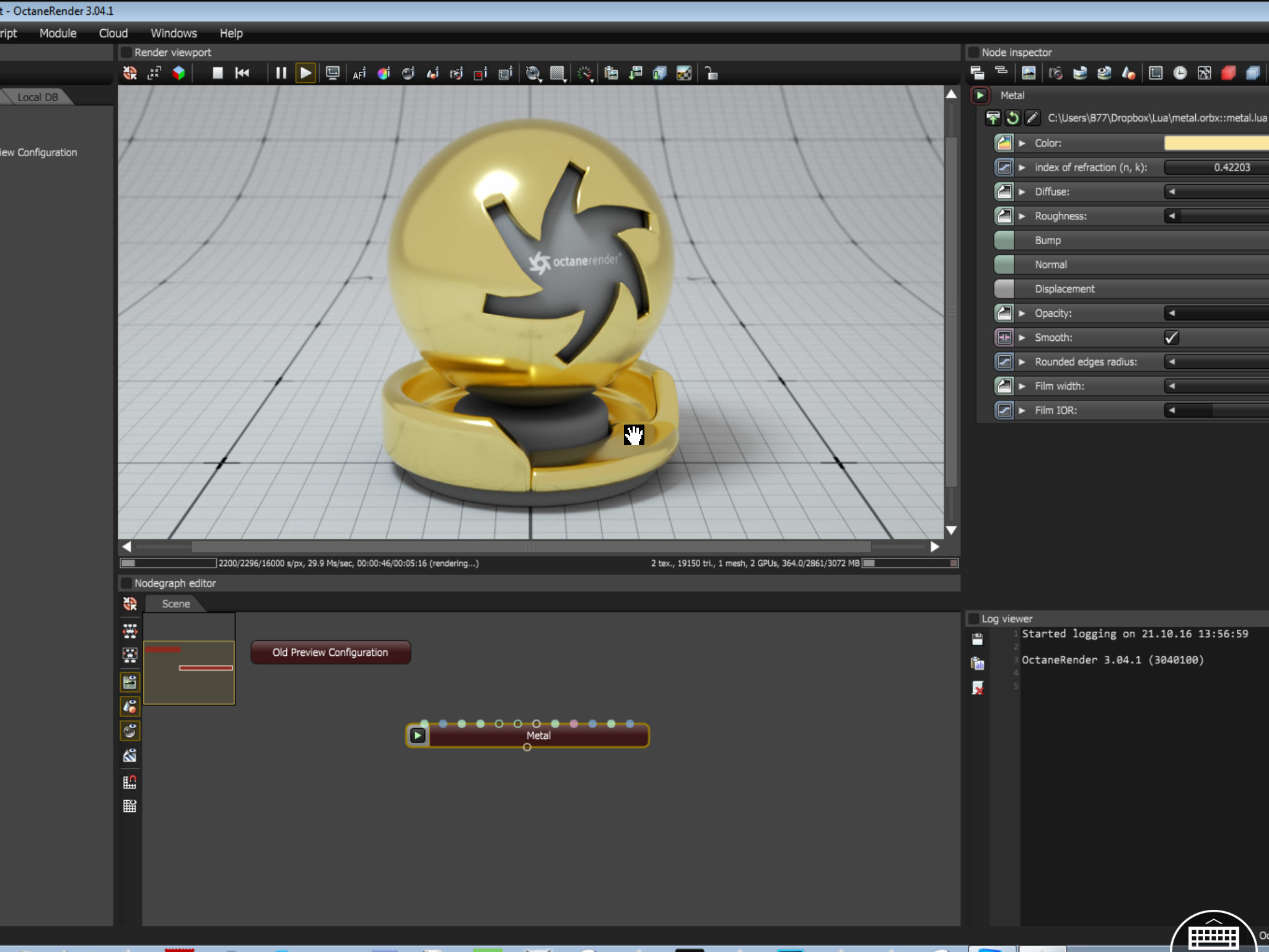

bepeg4d wrote:Are you sure Elvis?
Here is working as expected:
The attachment IMG_0191.PNG is no longer available
ciao beppe
