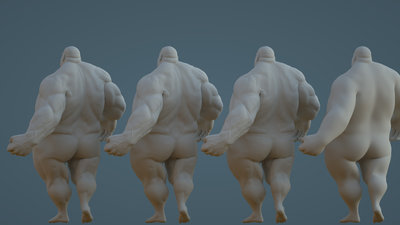

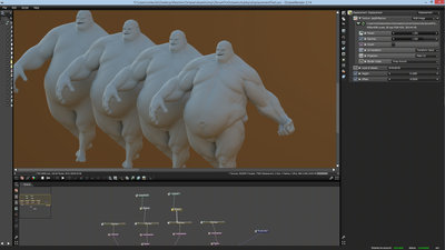

here are a couple of images of probably a better test,Model is from Zbrush.
I rendered the base proxy, the clamped Dmap, the unclamped with negative and positives dmap and the sculpted hi res model together to compare.
There seem to be a bug with the scale value in the Dmap node, it doesnt like values around 1,so the scale of the model is affected which is a bummer,had to scale it down to 0.1 and still some artifacts around the ear and face , values around (0.001) is all good.

gordonrobb wrote:Also, is your point more about a work flow that makes sure you are getting the right amount of displacement without it being trial and error?
hey Gordonrobb, yes,the values at render time are raw values from Zbrush, so there is no trial and error.
