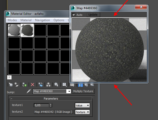

displacement generates geometry at render time (that you don't have in your viewport). the gpu's need that raw geometry. so altering your settings will result in recalculating and reuploading the geometry to the gpu's I guess.mbetke wrote: Also, if I change displacement values in material editor while having open the interactive window it takes around 10-15 seconds until it updates. I can live with it but is it intended? Seems the CPU is pretty busy while doing the displacement calculations?
alternative (for speed improvement and/or gpu memory lowering): normal bump or bump. especially with normal bump you can achieve great results. but I guess you know that
