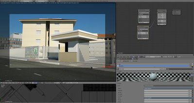

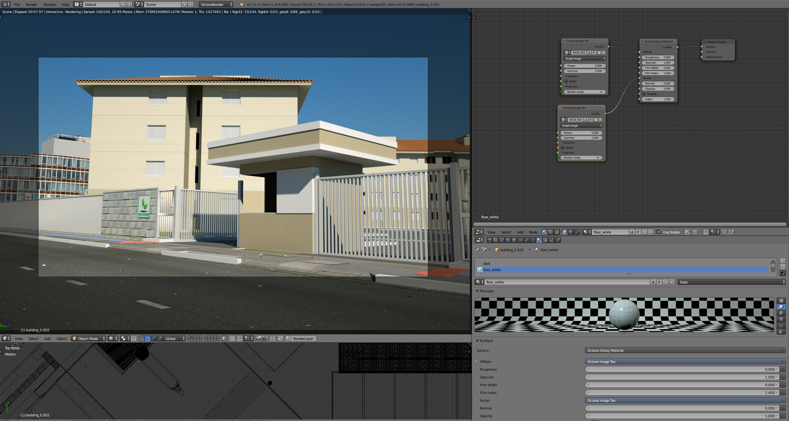

leonnn1 wrote:On the images you sent showed on the thread, as you can see, the building on the background is still swapping textures, at the first image that is on material shading you can see a building on the back texturized, but when you enter on the rendered shading it disappears too, the thing here is that the materials are not disappearing very close to the eye I think.
Still wrong.
The reason of that is simple: I just by intention did not spend the time unpacking all the textures of background hardly visible objects, as the amount of foreground objects is enough to see that all works OK using actual 1.55 - 5.2 plugin. So, this background object just has textures not unpacked.
As soon as I unpack its textures - this object always shows absolutely OK too, in both material view and in render-view, no matter how many times you switch back and forth.
