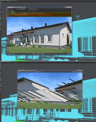

Another weird problem :
I installed the new Beta today. I was testing the new render passes with an old scene. I started rendering normally with F9 as before. Everything looks ok in render preview window. But when the image is finished, the final image is warped. See attached. What the heck?
