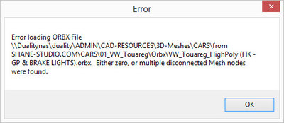

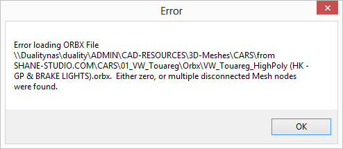

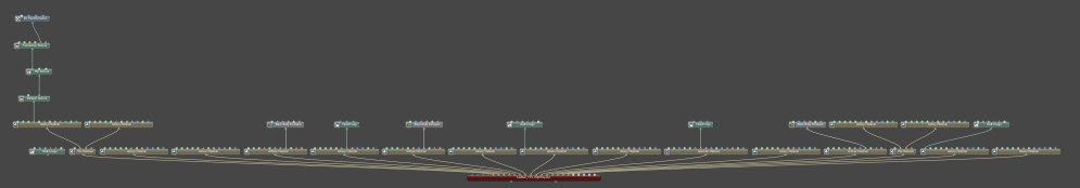

I installed 2.12.1.19 and I could get the ORBX proxy to load with a very simple ORBX file with no nodes attached but it's still not working with other ORBX files and I get the error below, complaining about unconnected nodes. But there are no disconnected nodes in the file - node structure attached (I know it's small but it's just to confirm that there are no disconnected nodes. I removed render target and environment nodes - still, no luck.
As a matter of interest, could you not make the plugin simply ignore disconnected / floating nodes?
Best,
Seeker
Hi Seeker - the ORBX needs to have one MESH node not plugged into anything. If you send me the ORBX's you are trying to load, I can check them out.
Paul
Hi Hendrik - the ORBX needs to have one MESH node not plugged into anything. If you send me the ORBX's you are trying to load, I can check them out.
Paul
I get that we can only have one mesh not plugged into anything, but does it work both ways? I.e. can something (material nodes) be plugged into the mesh node?
Cheers,
Seeker

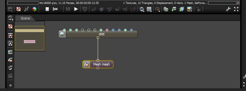

Yes - you can plugin materials in. The ORBX you load as the proxy should look something like below in Standalone....
Paul
