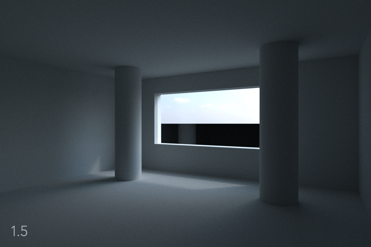

Good to see the speed return. Looks like 1.5 users who were unhappy with sizable 2.0 speed loss can feel better. In a simple interior test, 1.5 still had higher Ms/s than 2.1 (10ms/s vs 9), but after pausing the render 2 minutes in, there was less noise in 2.1 (term power set to default .3). Raising the term power up to .5 increased Ms/s to 12, but left some more noise in the shadows at the 2 minute mark. This could be very different story in a scene less dominated by shadows.
Also, coherent mode is a must if you want to see speed on par with 1.5, according to my test.
Still my personal view on speed is that focusing on Ms/s is fun and easy for all of us to do, but it's deceiving and not totally relevant in production. It's about balancing the best final render quality in the time allowed. In this admittedly simple test, 2.1 seems to have improved over 1.5, not just 2.0.
best viewed at full size

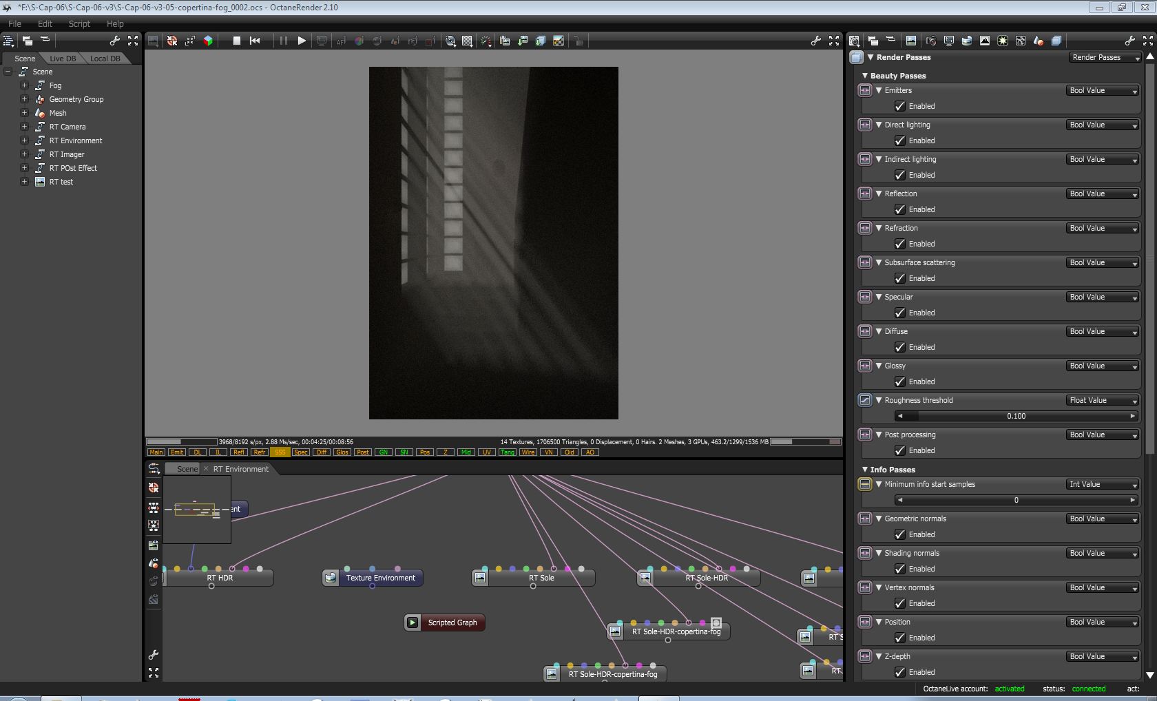

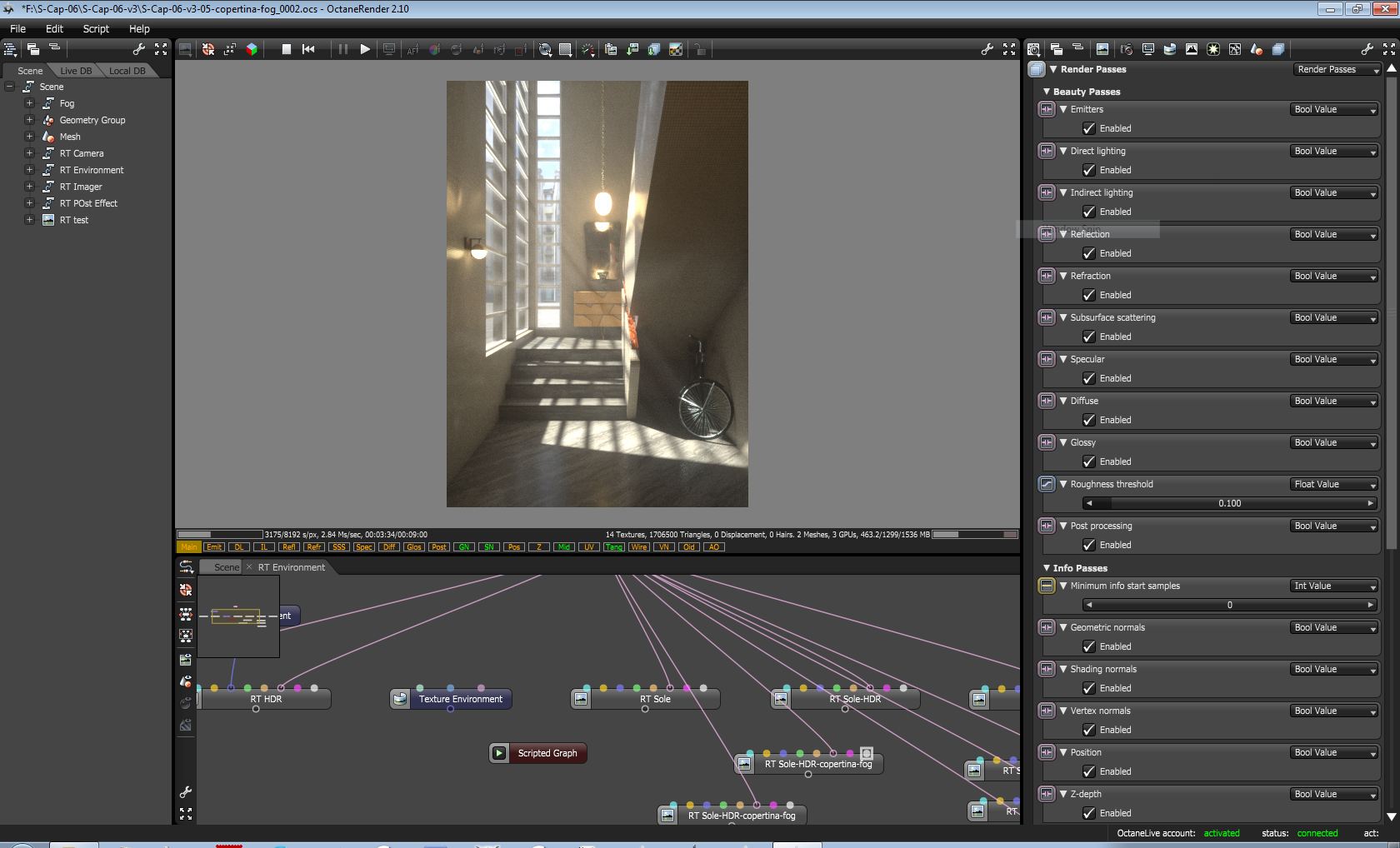

here's a couple of screenshots of render passes in action with normal beauty and sss of the classic cube fog:
wonderful :D
