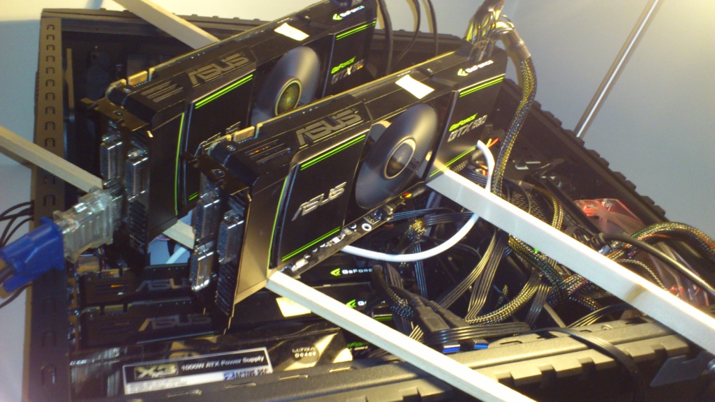

I have 16x to 16x (powered) - DIY stile - made it myself - works great
Impressive. How?
I did this method - https://bitcointalk.org/index.php?topic=76121.0 - then i prayed a lot not to burn MB and GPUs...hehehehe....and all worked perfect :D
I have 1x to 16x (powered)- the normal one - works in 1x pci slot (doesn't work in 8x or 16x pci slot of MB)
Is that because it does not fit?
well it fits, i can connect the 1x plug to the 16x slot in MB, but i get blue screen, or laggy UI in Windows...it trys to install the new hardware (gtx 590) and it takes to much time, and only recognize 1 gpu (of the 2 gpus from gtx590)

Well i will try to connect the 4 gtx 590 now..... :roll: :roll:
if all goes well i still need to find a way to secure all those gtx590 outsider the case. :twisted:

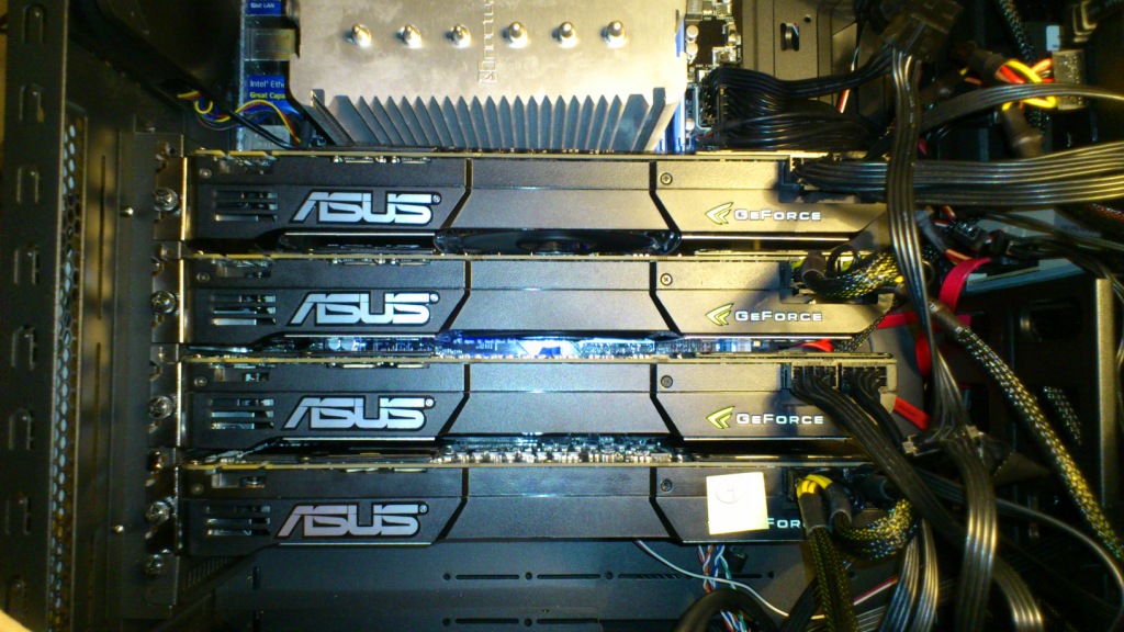

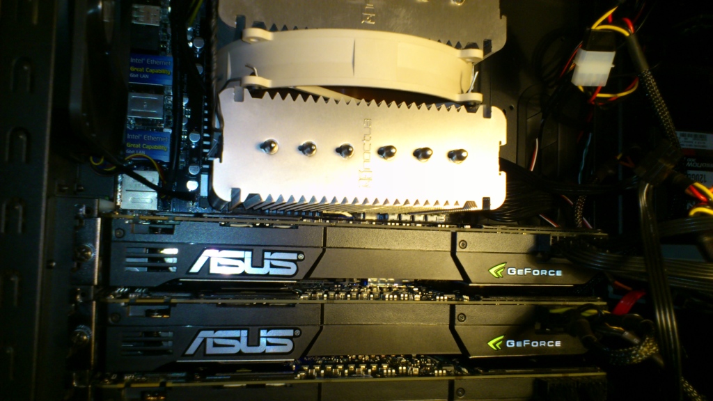

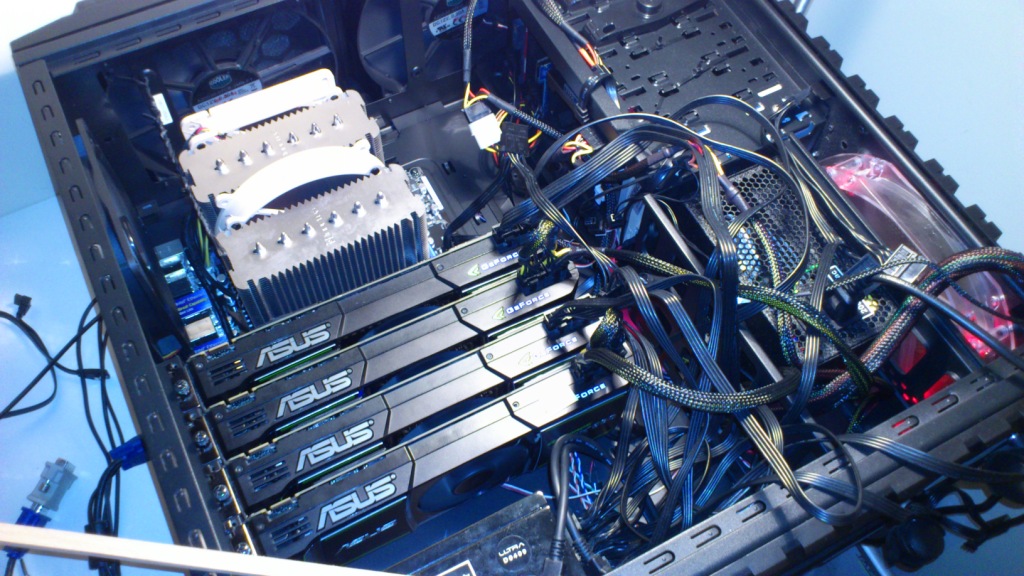

I managed to get 4 GTX590 working, but only if connected directly to the MB pci slots....but temps just go UP because there is no space to get enough air in. Tested to see if was a power problem but...it works very well, 1600w power draw...so 1900w is more then enough.

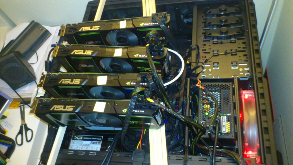

At some point I managed to get 4gtx590+FX1800 working (FX1800 to display, 2gtx590 inside the case and 2gtx590 outside with risers)

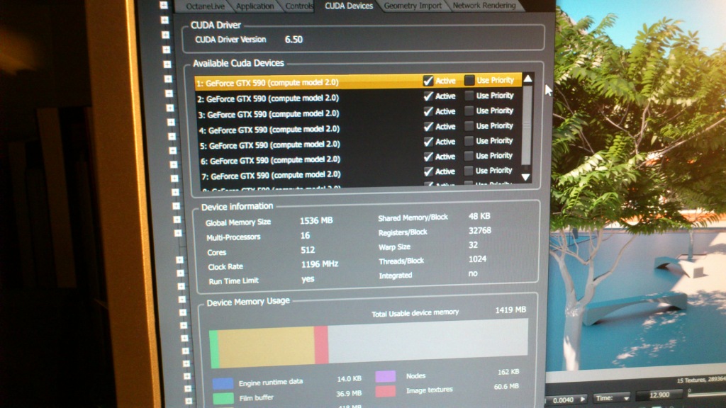

I thought it was all good......but....... :evil: :evil: :evil: Evga Precision, and MSI Afterburner can't control 9 GPUs.....??
While trying to get a solution to that problem I lost so much time I was forced to get back to 1 FX1800 + 2gtx590 so I can get my projects going...I'm already to late and now need to step up and get my works up to date.
When the new USB risers arrive I will test again.
The problem with the 9 gpus really troubles me because in Evga Precision and MSI Afterburner the Gpu Fan´s of the gtx590 is controlled in pair, because 1gtx590 have 2 gpus(1 is master and 1 is slave) the apliucation read the temps from the master Gpu and then increases the fan speed. The 9 gpu problem comes because, only 8 gpus are displayed in Evga Precision and MSI Afterburner, so one of the Gpu's of the last gtx590 is not read, this last Gpu is the master of the 4th gtx590....so it get hot as the fan stays slow. :roll: :roll:
