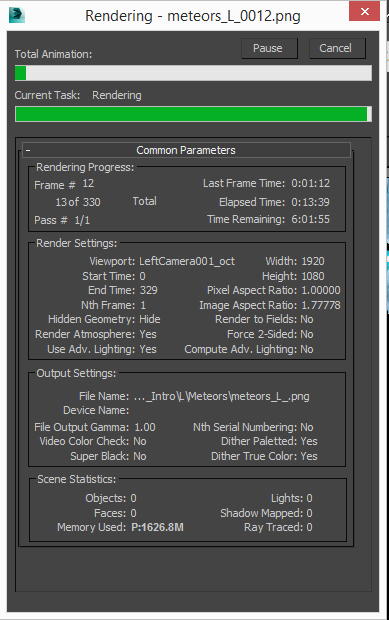

So the log text file should be copied into the Max plugins folder with the Octane.dll? I'm using two slave machines, but I've tried using only one at a time and it still does it. I'm also pretty sure I've had the problem without using any slaves and just the local machine. I'm rendering 8,000 samples, and I've tried 16,000 with a similar result. I can't see how many samples are left as it of course uses the Max frame buffer which doesn't display any useful information. The only thing I can see is that the progress bar is always fully to the right, looks like 99.99% complete.

I'm not having much luck with the Log file on the master machine, I run Max as Admin and it does create a Log file but it is 0kb and doesn't have any info in there. I've also attached a screengrab of how the rendering progress looks when the problem occurs.

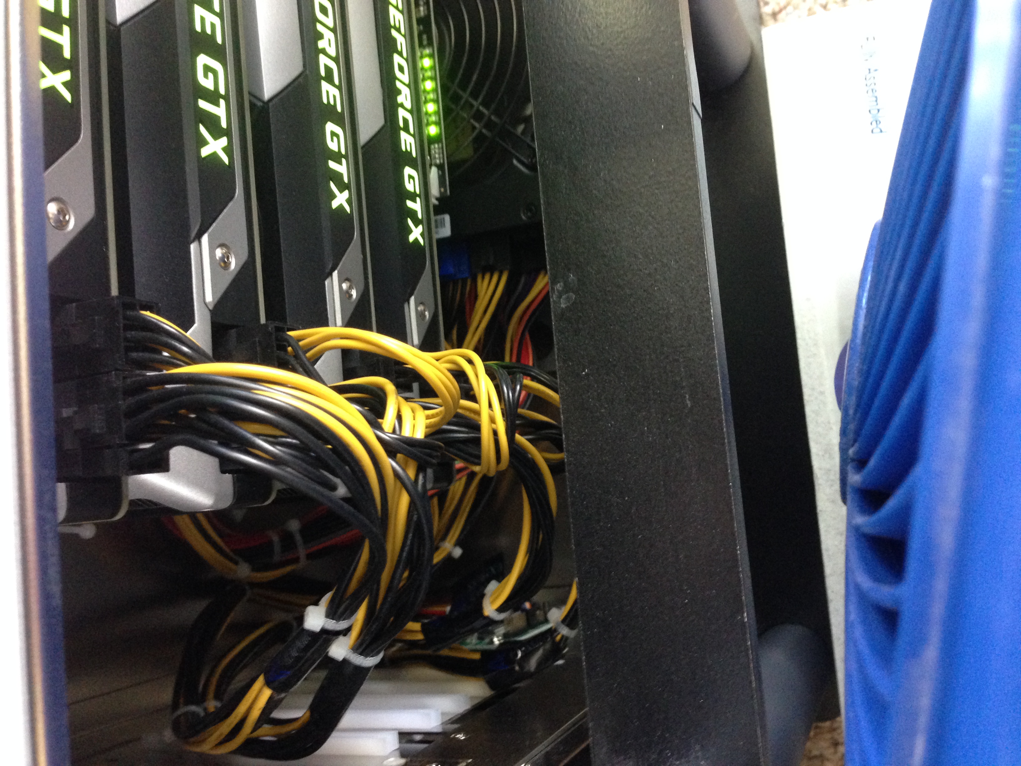

I placed a large fan blowing at 4 cards and especially PSU rendering does not stoop anymore! If I turn fan off it will stop in about 10 minutes. I think cards get hot but the main reason PSU gets overheated supplying cards with less power. Try it it might help

i know, all these fans are loud and it looks bad. but it still works fine. Mine was PSU getting too hot and too weak not actual cards. cards always run around 65-70

We've got a 1500w psu in each of the machines, if these aren't up to the task then I'm not sure who Otoy are making this renderer for? There aren't really any powerful supplies that are more power. It's frustrating that this is called a 'hardware issue' when we've just spent a load of money on top end gpus, psu, etc. and then told that it isn't enough for Octane.

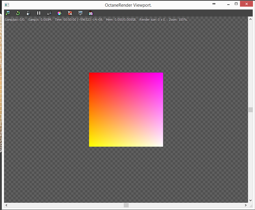

and now all of a sudden getting this problem (see attachment), this has suddenly happened on 3 separate machines, not using network rendering, tried opening a few different scenes, nothing is rendering. This is getting ridiculous.
it seems to be caused by some materials, mostly mix materials. if I change those materials the render starts. This has only happened since 2.04.
further investigation seems to show that it is emission textures. If I tweak the value ever so slightly suddenly the render will start... what is this all about?
and using the material editor crashes the scene a lot.
A few more tests and I'm even more confused. Seems to just be one scene in particular, and this scene has been working ok. I've gone and loaded previous iterations of the same scene that definitely worked, and they're all coming up with this same error. Sometimes I can trick it into rendering by swapping the material, or changing a value, but it doesn't always work, and there's no way I can actually render this scene. And it seems to kind of 'infect' 3Ds Max; once I've tried to render this scene and had the orangey pinkish square, if I open another scene that would otherwise work it will still just show the orangey pink square and refuse to render until I restart Max.
