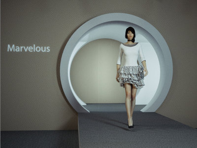

I have a 1 pixel width line in the middle of the image. It's very thin bun still noticeable. I've tried any resolution but line doesn't go away. 2 Quadro FX 4800, octane 2.3v5

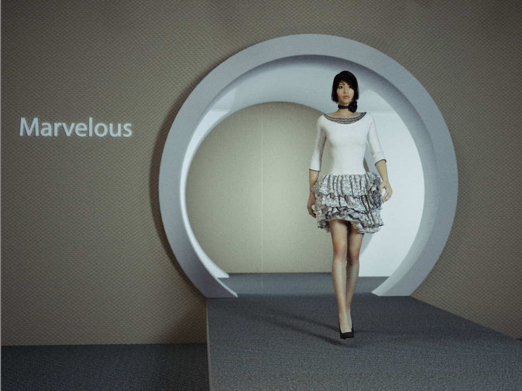

I have a 1 pixel width line in the middle of the image with pathtracing.
2*GTX470, octane 2.3v5, win7KOR,12GB ram,i7-950

off topic....where can I get that girl?
