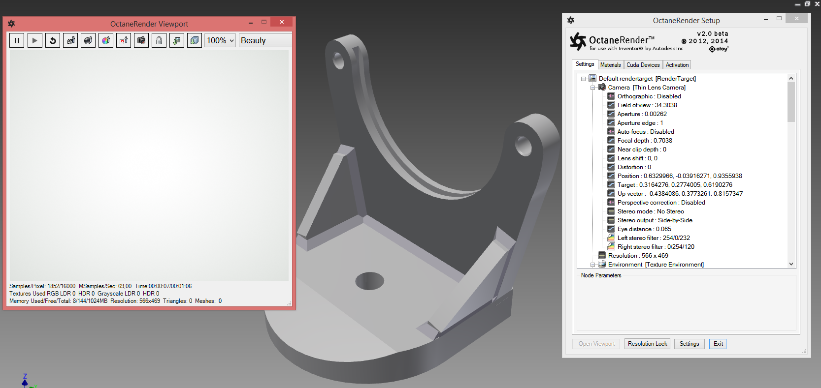

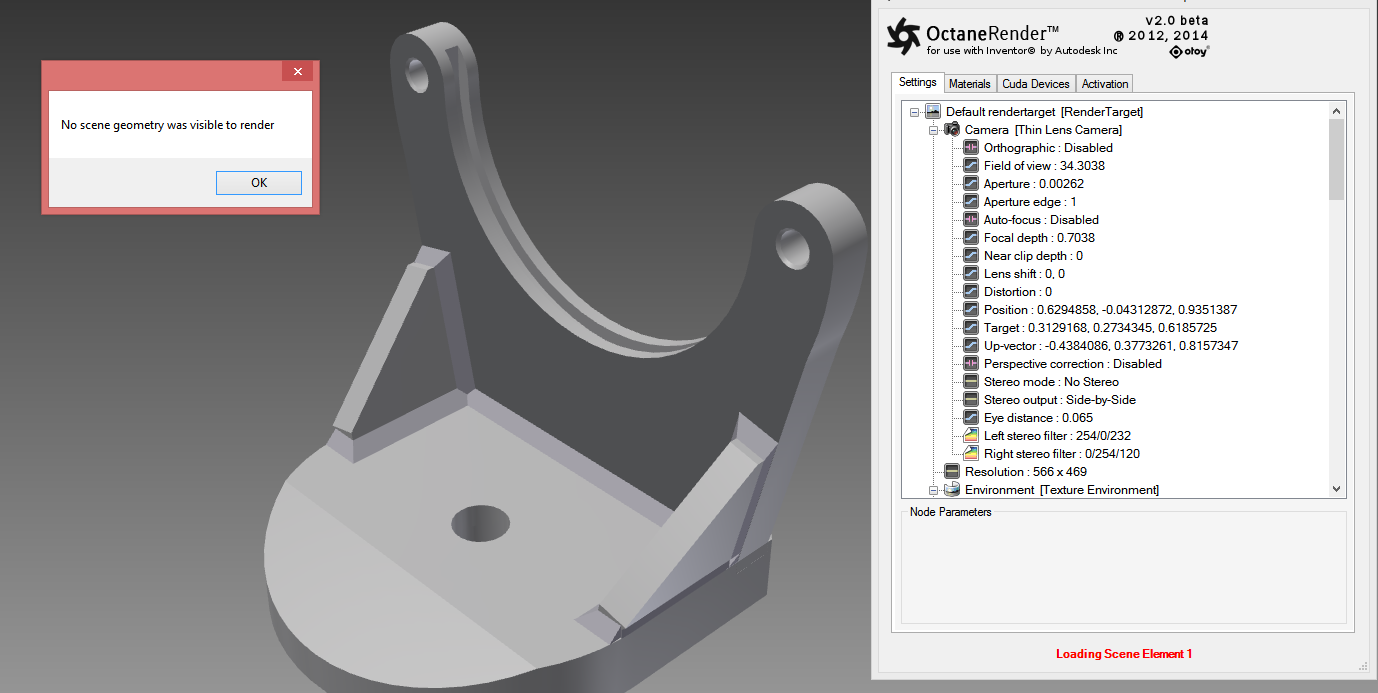

How are you setting the Inventor element to "Invisible" pls?
As always, RMB on model -> Visibslity. Checked it on many assemblies, it doesn't work for Octane.
I suggest rotating the IBL image, or rotating the actual Inventor element being rendered.
Yes, this way I'm currently using.

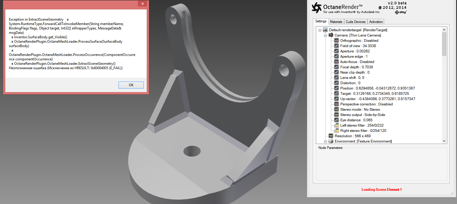

I find out that errors appear when I try to open some files that was originally made in Inventor 2014, but resaved to 2015. There is no problems with originally inventor 2015 files.
I will fix the Visibility issue in the next release - which is probably 1-2 weeks away.

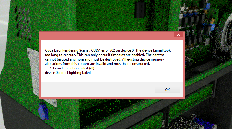

And now I can't render big scenes (around 900 elements). The error is shown below. It apear when Viewport is opening.
I tried to disable watchdog timer, but it doesn't help.
Firstly - have you checked FAQ question 2) at http://render.otoy.com/manuals/AutoCAD/?page_id=416? If you install the Octane 2.0 installer, it will set the right registry settings for you. Secondly, can you pls tell me your hardware setup (as requested in http://render.otoy.com/forum/viewtopic.php?f=63&t=40469). If you put your hardware settings in your forum signature, that helps a help.

About FAQ - yes, I saw it. In registry I was find next settings: TdrLevel = 3, TdrDelay = 10.
With this settings plugin doesn't work. I have tried to change TdrDelay to 20, then to 50.
After that I have changed TdrLevel to 1 and it's still not successful.

- Inventor solids with Visibility disabled are no longer rendered in the OctaneRender Viewport

But the problem with big assemblies is still present (error 702).

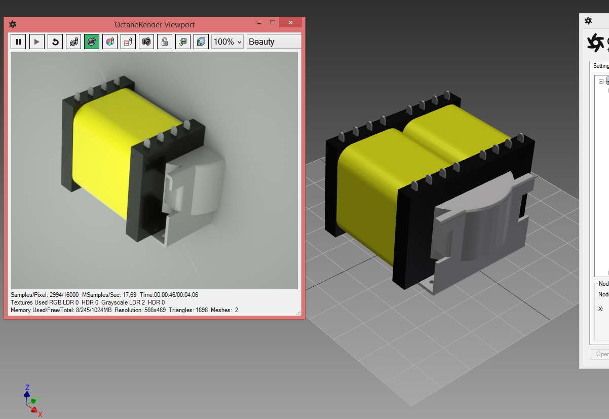

And I found few problems:
- ground plane recognised incorrect (you can see it in picture)
- assemblies with welding are invisible in viewport.
I tried to convert one of them in STEP for sending to you, but when I opened STEP file in Inventor, it rendered ok, unlike the original...
How can I solve this problem?
Can you pls send me one of the big assemblies causing this error and I will take a closer look.
This is because Octane assumes the Y axis is UP, and in your scene the Z axis is up. To resolve this, double click the View Cube Front, then rightclick "Set Current View As Top". Then reload the scene into Octane and the ground plane will match Inventor. You will need to rotate your part if you do this. Alternatively, place an Inventor plane to use as the ground plane.
Fixed in the next release.
