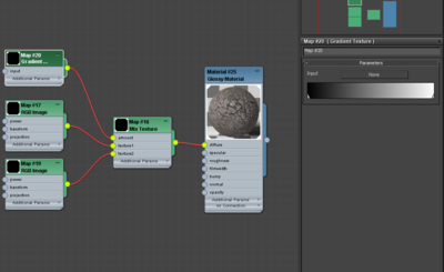

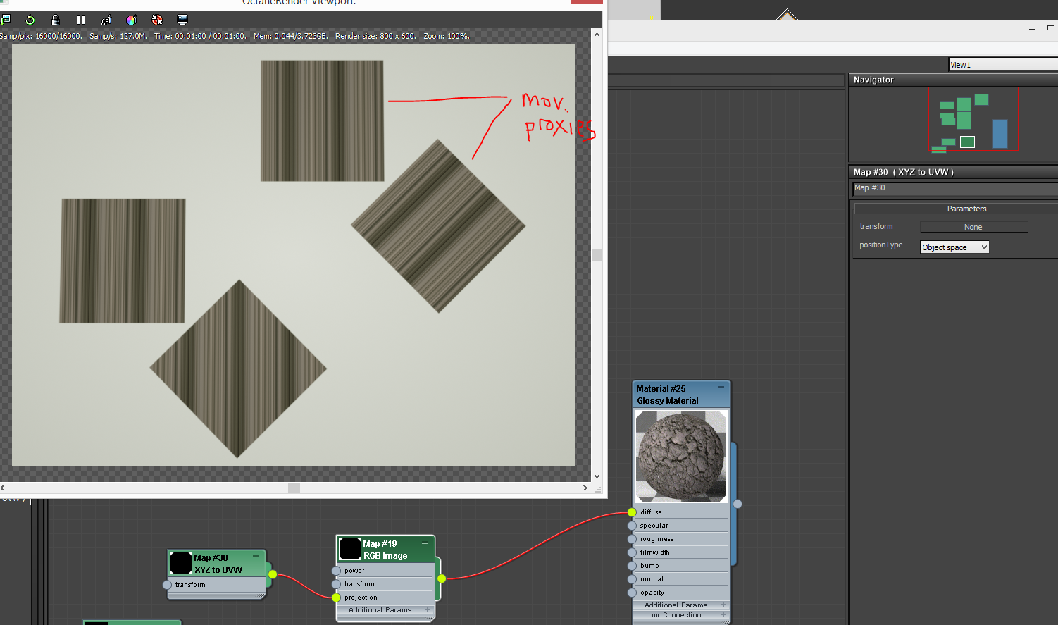

tnx for the release.
about that gradient texture.
IMO that texture should work in situations like shown in my screenshot and should have projection/transform settings, too:
I really do not get how this should work at the moment.
tnx
boris
tnx
boris
