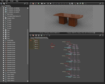

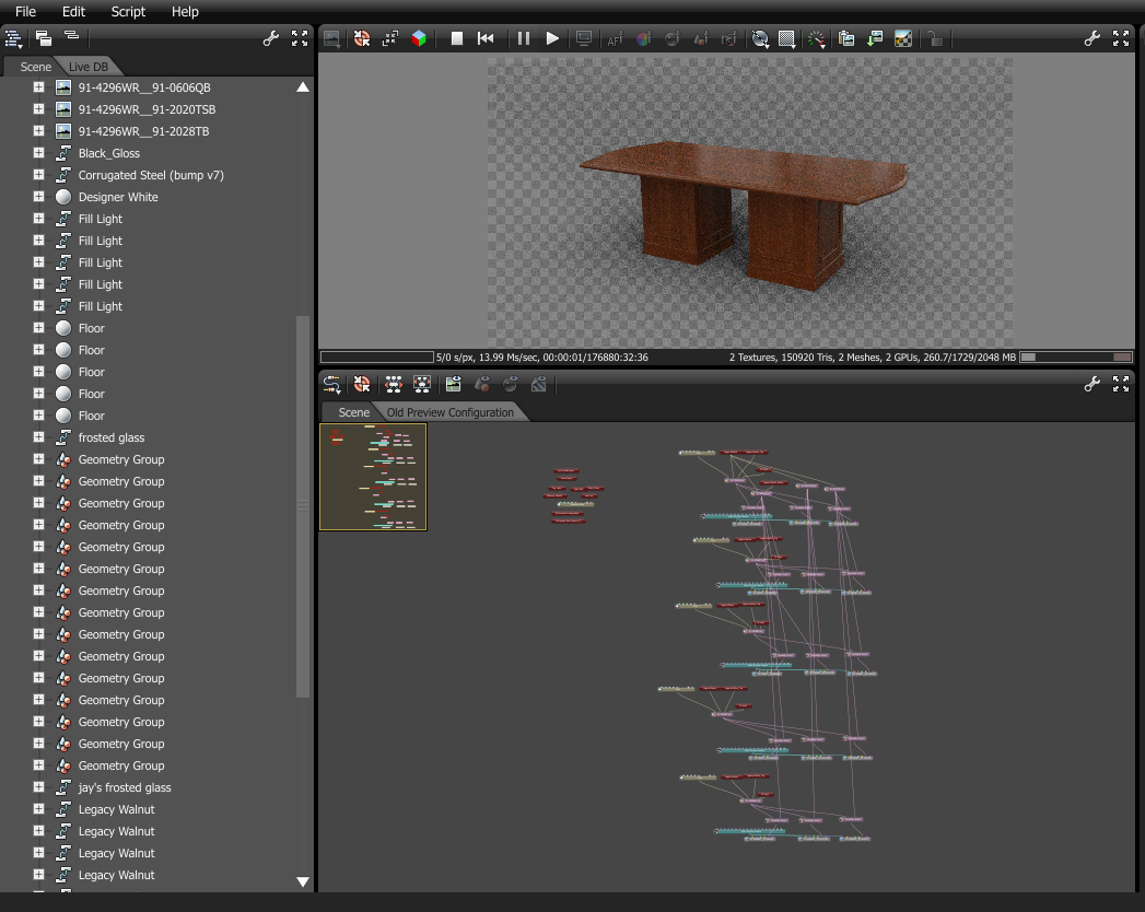

Loving this script!
In my current project, we are rendering out conference tables. For this set, there is several different tops, but only 3 bases. I was able to export the bases separately and the rest of the scene by itself. Then quickly create geometry groups to add my 5 tops to the 3 bases. Setup my 15 render targets and now I can just let it go over night :)
In the image, each horizontal line is a different top.
After this, the next product line has 5 tops and 8 bases. Each top has a couple of different sizes.
So by just importing each base once and each top once (everything will fit in my VRAM) I will setup to render over 100 different item images. I hope this works, haha.
As a side note, it would be really cool to have it show a checklist for each render target, so you can turn them off and on for the batch render. For instance, if I have to add one more base to this product line, it will be very easy to bring it in, connect it to my preexisting tops and render them out. But I would have to delete all of my other render targets so it only renders what I want. If you have a scene with 4 camera views, you may want to render 3 of them, but not the 4th. ect.
Thank you so much for this script!
(Edit: didnt upload image)
