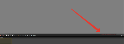

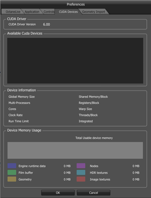

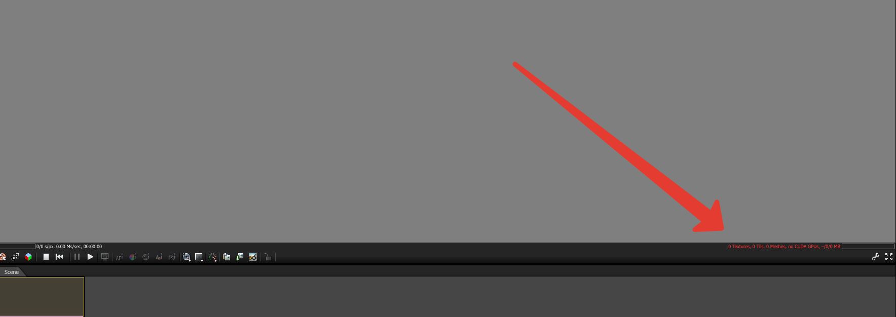

Octane don't see my Gfx 780... message: no CUDA GPU's
see attachments

xrex wrote:Octane don't see my Gfx 780... message: no CUDA GPU's
see attachments
Hi
you use EVGA PRECISION ?
Go to Voltage and turn Off " K-Boost " :D
it´s work for me GTX780Ti + (470(dedicate to physx))
