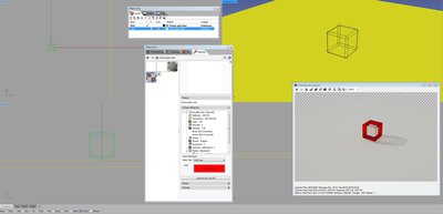

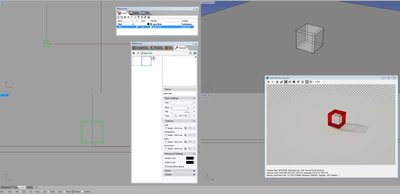

Hello Paul,
I just found the time to continue testing your latest test build (thanks!)
I thought I would test a few old issues, here is no 1:
Rhino materials with a reflection value are rendered with a red tint. After converting the rhino material to an Octane material it is obvious why (please see picture no2): the reflection value is not 255/255/255 but 254/0/0.
As I understand octane deduces the material properties for conversion from the materials viewport appearance, this is also true for vray material conversion.
As I am doing a lot of old scenes with already set up materials, it would further ease my workflow, if this issue could be addressed.

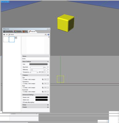

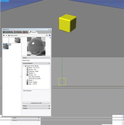

Hello Paul,
here is another one:
as you see on the pictures a 10 % reflective / IOR 5.0 rhino material gets converted to a octane material with a specular level of 2.55! (normally it should be 1.0 max) and a standard IOR of 1.45.
I dont know if there is any chance to convert a e.g. 10% reflective material to a octane material with a specular value of 0.1 and translate the IOR value as well?
The 2.55 value is probably more a "cosmetic" problem, since it behaves the same as an object with the same material with a 1.0 value in my tests , still it might be confusing to someone.
