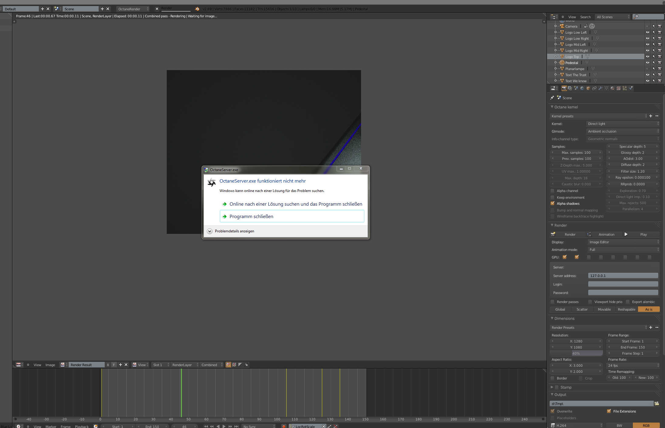

Another thing I noticed: It doesn't finish the render. I gave my scene 5000 samples, but it stoppped rendering at 4902 (or: it stops updating the status bar for the last sample, who knows). Graphics card powers down at the moment of that screenshot.

Sigh .. yet another problem :) I was in the middle of rendering an animation, when somehow octane server refused access (also had a bad login/pw entry in the render tab .. accidentally had the logon for the webpage there). No issue, tzried to put in the right none again ... to no availa ... it refuses access with a bad PW combo. Ok, I tried reinstalling the octane server .. didn't help, either :/ Retried right combo in blender and just rendered .. and it worked. But where did it suddenly pick up the wrong login in between? does that get saved in the blend file?
EDIT: it just crashed again right in the middle of animation rendering..
Might be related to soemthing corrupt in blender though, as also the animation didn't at first play anymore in solid mode/3D view ... I tried setting the keyframes again and then it seemed to work.
