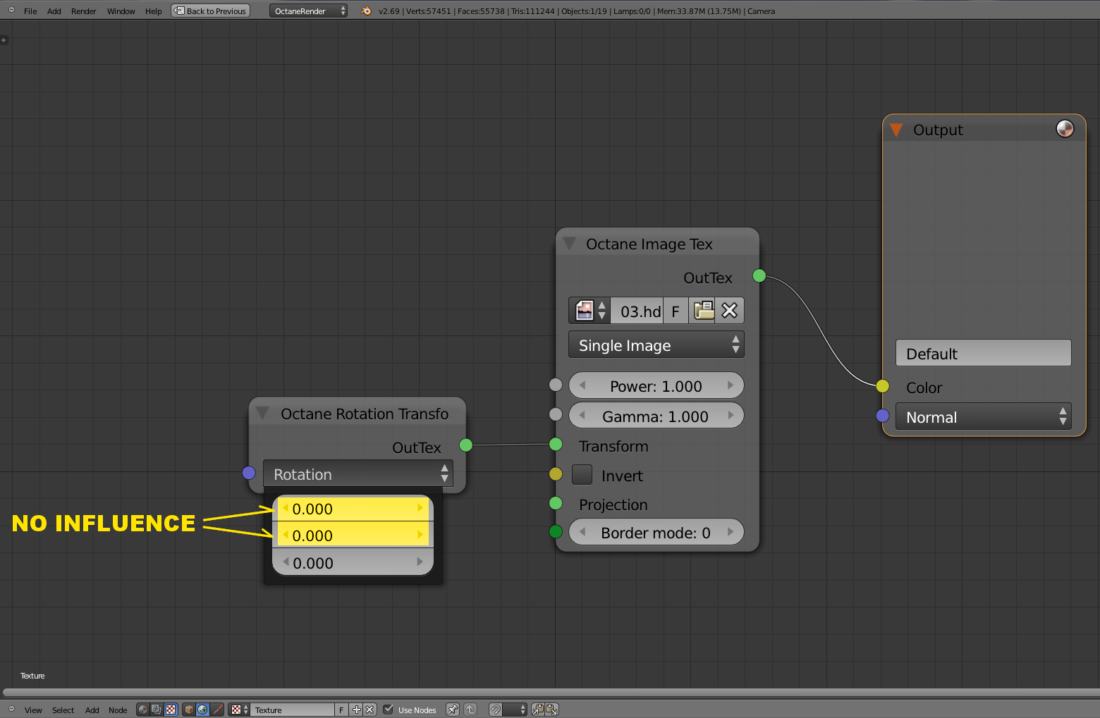

I'm having a problem with rotating an hdri texture. It seems that X and Y inputs have no influence on the rotation during live viewport rendering, no matter if I'm using Octane Rotate Transform or Octane Full Transform. Am I missing something?
Thanks in advance, cheers.
EDIT: OK, now I know, I should have used Translation instead of Rotation. Sorry for that.
