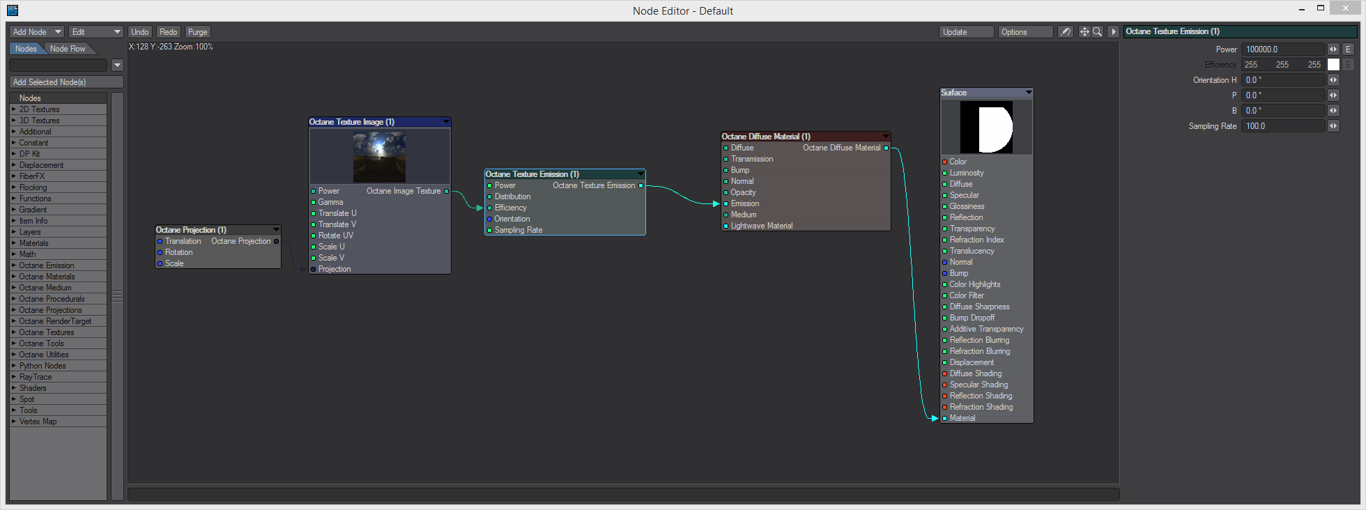

When using Octane Texture Emission node it's power value doesn't have any effect if I go over 100000, as if all higher values get clipped to this number so I can't crank up the emission of my HDRI image.

BorisGoreta wrote:When using Octane Texture Emission node it's power value doesn't have any effect if I go over 100000, as if all higher values get clipped to this number so I can't crank up the emission of my HDRI image.
As you can see in Standalone app, the upper limit for this value es 100000.0 ... perhaps you could add a color correction node between TextureImage and Emission node to try to get more power using the brightness or brightness scale parameters of this node.
-Juanjo

I still can't crank up emission of the environment HDRI texture, if I use color corrector it just clips the color values to 1.0.

BorisGoreta wrote:I still can't crank up emission of the environment HDRI texture, if I use color corrector it just clips the color values to 1.0.
Perhaps you should use large ISO or more exposure time if your scene is too dark with your HDRI environment.
