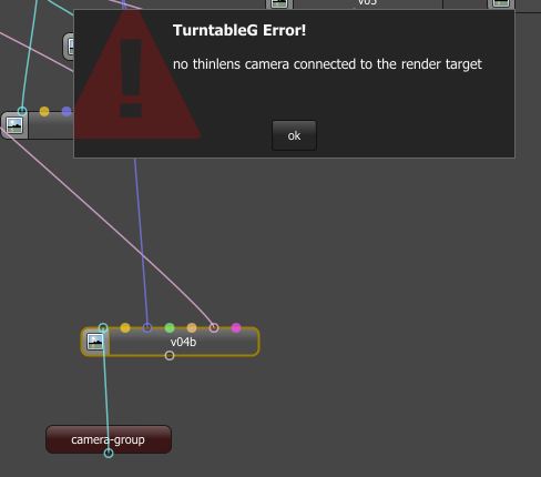

hi grimm,
thanks for the update, is turning out very well :)
there is an issue if the thin lens camera node is grouped:
the spiral option is very nice, and setting the angles to 0, it's easy to move the camera forward and backward :)
it would be wounderful if we could change the axis independently for both the primal rotation and spiral movement, for a basic but efficient camera motion system ;)
p.s.i'm not able to save or load any configuration on both, mac and pc :roll:

bepeg4d wrote:hi grimm,
ciao beppe
Thanks Beppe,
The thin lens problem is a bit out of my league right now so hopefully Thomas or Roeland will chime in.
I would like to be able to rotate the path, etc., but I'm going to have to get back up to speed on the math to do it. :)
That is strange that the save and load doesn't work on the Mac, I was worried about the PC, but the Mac's OS is very close to Linux in how it works? This should be solved when the 1.24 version of Octane is released. Then I can point the script to it's own subdirectory and the defaults file can be written there which should make all platforms happy.

Hi there,
The render target node is not connected to the camera directly but to the output linker node of the graph (of type octane.NT_OUT_CAMERA). Remember, linker nodes aren't anything special or scary. The only thing they do is provide for the connections between nodes outside the graph and nodes inside the graph.
What you need to do is: if the render target is connected to a linker, you should skip it. By skipping I mean trying the node that's connected to this linker node. You keep doing this until you hit nil (no connected node) or a non-linker node. In turntableG_anim.lua you would add this function:
Code: Select all
-- Returns the connected node, skipping all the linker nodes in between.
-- So it returns the "Real" input node.
local function getInputNode(node, pinId)
    local connected = node:getConnectedNode(pinId)
    -- no node connected to pin
    if connected == nil then return connected end
    -- a regular node connected to the pin
    if not connected:getProperties().isLinker then return connected end
    -- a linker node, return the node connected to the input pin of the linker
    return getInputNode(connected, octane.P_INPUT)
end
In getSceneCopy() you would use this function:
Code: Select all
-- check if a thin lens camera is connected to the render target
local copyCam = copyRt:getInputNode(octane.P_CAMERA)
if not copyCam or copyCam :getProperties().type ~= octane.NT_CAM_THINLENS then
    showError("TurntableG Error!","no thinlens camera connected to the render target", true)
end
We'll add a function getInputNode() to the API in 1.24. I'll create a seperate post afterwards to explain the difference between getInputNode and getConnectedNode because I guess a lot of people are going to hit this problem (i.e. where there scripts suddenly fail when graphs are involved).
I hope this helps for now.
cheers,
Thomas

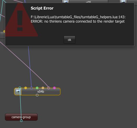

Hi Thomas,
Still have some problems with the code fix: :oops:
Did you mean:
Code: Select all
local copyCam = getInputNode(copyRt, octane.P_CAMERA)
instead of:
Code: Select all
Even with changing that line of code I'm still getting an error:
"attempt to call method 'getConnectedNode' (a nil value)"
on this line:
Code: Select all
Now my test scene is real simple, all I have is a mesh node with two render targets connected to it. To test this I grouped both of the target nodes, would this work?
Thanks,
Jason
